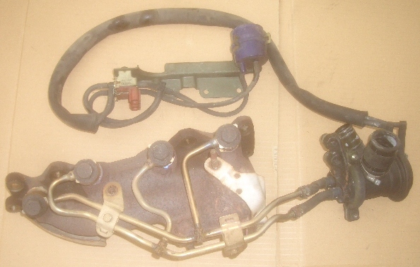

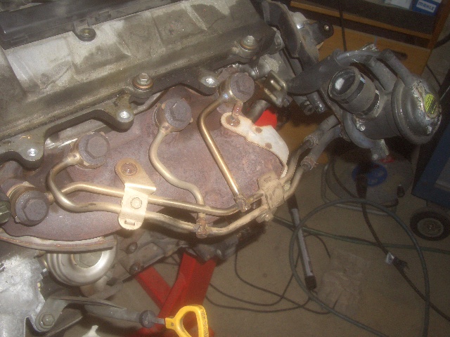

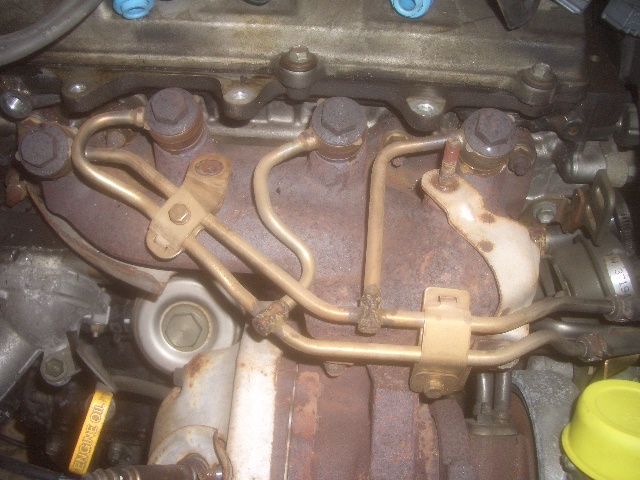

actually, WRC ST205's came with air injection anti lag from the factory. when activated, it takes the air from the bypass and shoots it into the manifold
however, good luck getting any turbo life out of it. even ball bearing turbos will die within 10k or so. its not ment to be on a street car, and the only reason it was put on ST205s was for WRC rules. i should add that they do not spool the turbo with the injected air, the air is simply to give the raw fuel a way to explode. When lifting off the throttle quickly, the BOV diverts air into the exhaust stream while the computer would add extra fuel and heavily retard the spark timing causing the fuel to be ignited by the late spark while the fuel was being pushed out the exhaust valves. you can also use a standalone to pull this off
