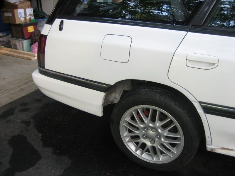

Rear quarter rust repair in progress...

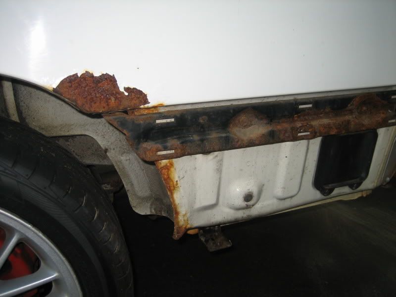

This is the before I cut out the main part of the rusted quarter:
After the cut and use of the flange crimper thingy. you can see that I could not get the tool all the way accross the top of the cut because of the sheetmetal behind (wheel tub):

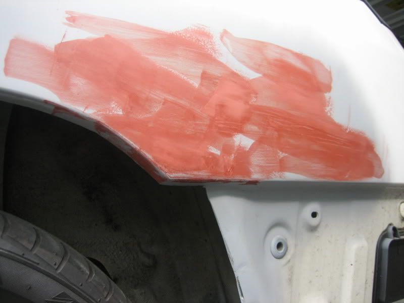

Sand, sand , sand, after a few thin layers of bondo to fill in low spots:
Primer:
Sand that down with about 600 grit then scim coat with Galzing Putty:
Sand that down with 600 grit and prime again: no pic yet.
Sand the primer down with 600 to get smooth and ready for paint: Doing this part today, pics later.

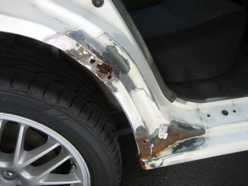

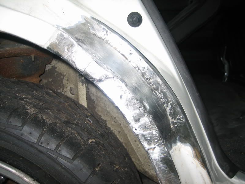

I had a busy weekend...

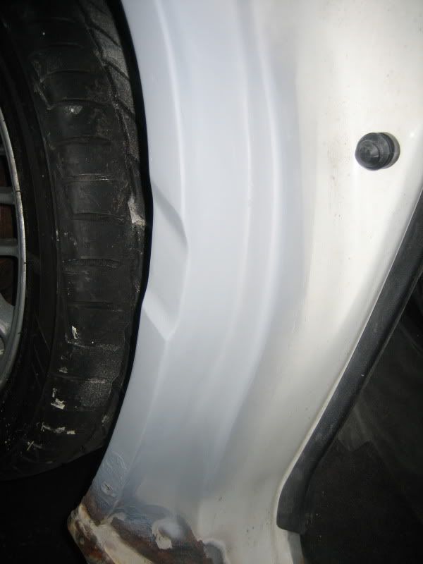

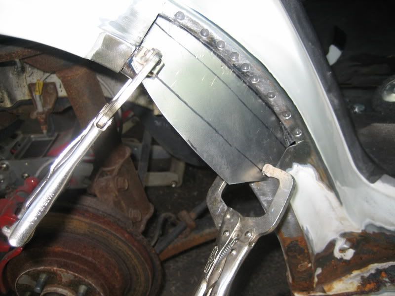

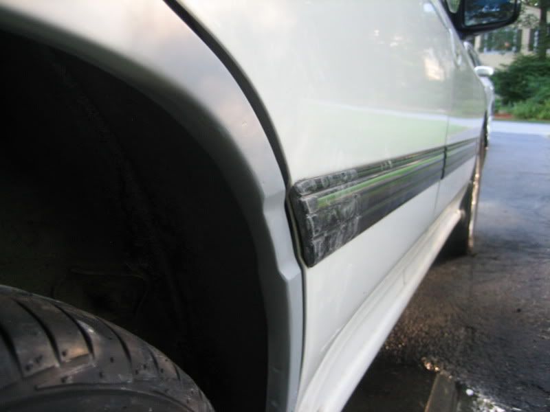

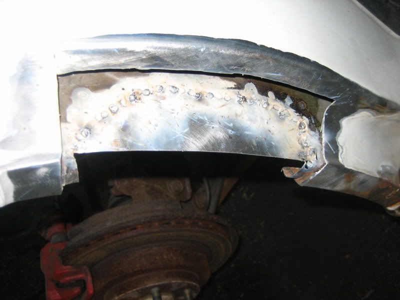

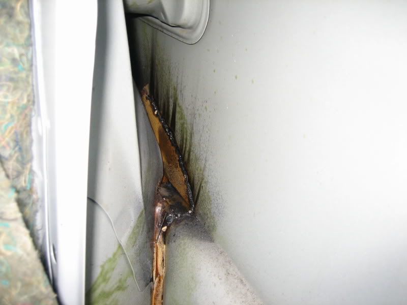

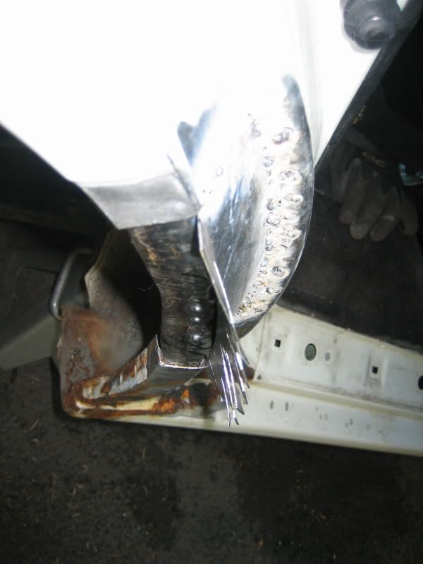

I set forth to tackle the passenger side front edge of the rear wheel arch where it has that step for the black moulding. This whole section was where the car was hit before and was patched up something horrible. I'm only focussed on the top section in this pic for the moment so I can paint the top part of the panel and leave a paint seam behind the black moulding strip. This eliminates overspray and blending later when I do the bottom part of the rust in the pic. I just want to get the bumper cover on the car so I can drive it again.
After I cut all the rot out:
This was the most challenging fix for me to date. you can see in the above pic that the rust also affected the wheel well tub so I have two layers to replace here on an arch with an indenct where the moulding goes. Whew!

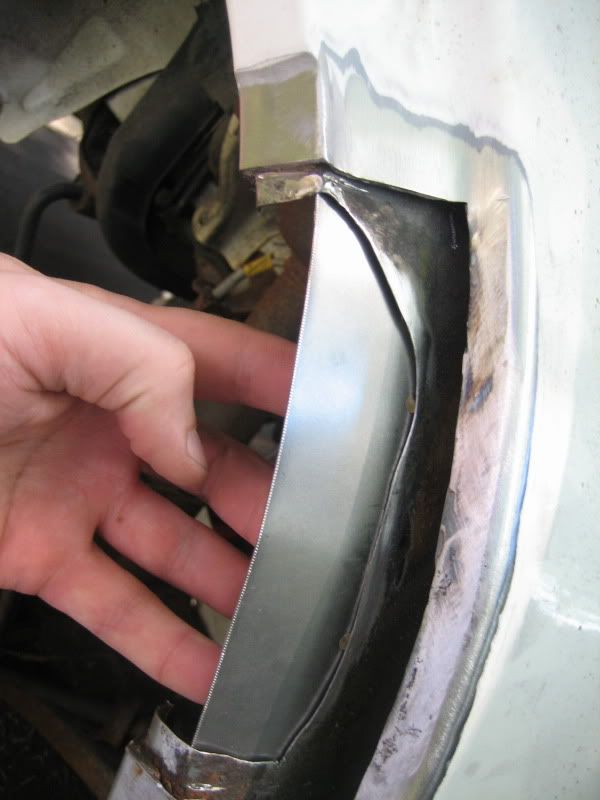

I cut a piece of sheetmetal and fit it up to the well:
Punched some holes with my crafty tool:
Clamped it up and welded it up:

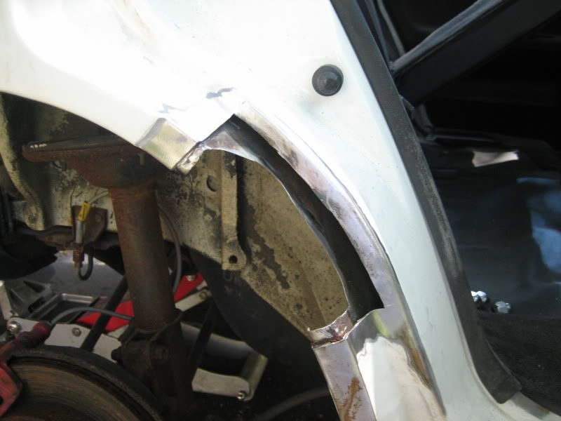

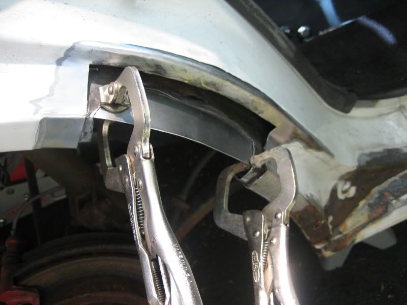

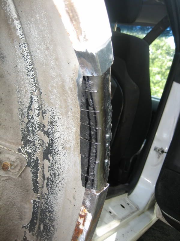

Because of all the compound bends in this area I opted to weld a bunch of curved pieces together rather than to try and make one whole piece with all these curves.
I then took a piece and welded it 90° to the first piece to make the outer edge of the arch. I outlined the arch from a template of the other side that was good and cut strips up to the curved line:

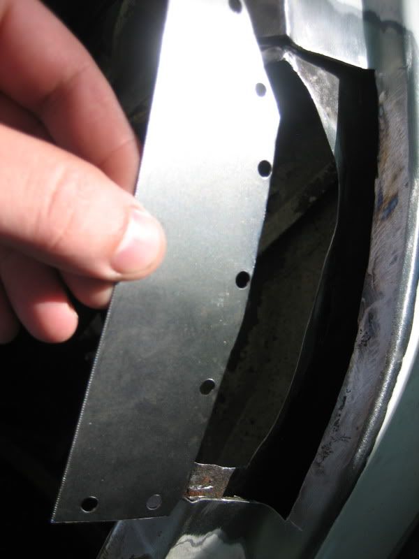

Now to the "Top part" or the outer sheetmetal.
I cut a piece to fit but left a 90° lip on the back side to fit behind the exsisting panel. I drilled some holes in the arch to get some welds in there:
I drew a line where the bend needed to be and cut the strips again:
After bending the front layer down I marked for where it needed to be depressed for the black trim and cut that part out leaving only the back layer in that area:
That's where I left off. I just need to fill in the holes with the putty, reprime, sand, and paint. I should have both quaters painted today. More pics to come tonight.

Its really too bad about the fact that you have a flux core setup,your metal skills are pretty decent and your work would be really quite nice with the proper welder.Not to say that your work there doesnt look great in final product form - which i guess is what counts.
magicmike
Posts: 2772
Location: USA, RI
Post by magicmike »
gijonas wrote:Its really too bad about the fact that you have a flux core setup,your metal skills are pretty decent and your work would be really quite nice with the proper welder.Not to say that your work there doesnt look great in final product form - which i guess is what counts.
I hear you. Thanks for saying my shitty welds look good after enough grinding and bondo'ing lmao. ;-) I'd love to have a nice TIG setup but can't really afford anything like that at the moment. not to mention this is the most welding I've ever done and its really only the 4th or 5th time total in my life that I've welded.

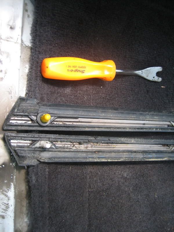

Those obnoxious clips with all the teeth that secure the molded plastic tabs on the inside of the bumper cover to the bracket. The tabs fit through the slots in the bracket and the clips fit over them, holding the cover fast to the brackets. The two closest to the wheels are accessible with a flat screwdriver, but not the rest. I took the brackets off with the bumper (hardware accessible inside the storage bins).
I guess the bumper has been removed previously?

ok I know what your talking about. Those came right off. I used my snap on panel popper tool though which has a bit of leverage. Seen here in this pic.
Came right off and the clips fell off too.

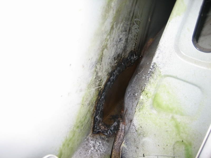

Mike - good stuff! The only comment I have is that all those outside welds will rust this winter without some good weld-seal. They make a weld seal plastic filler that I've had really good luck with. I've used it on 6 cars now over my welded body work and it's held up much better than regular bondo.
Avoiding the corner/edge cutting and welding was the reason I made the form - actually worked pretty well. What kind of primer are you using?

fishbone79 wrote:Mike - good stuff! The only comment I have is that all those outside welds will rust this winter without some good weld-seal. They make a weld seal plastic filler that I've had really good luck with. I've used it on 6 cars now over my welded body work and it's held up much better than regular bondo.
Thank you. As for the primer and bondo I just used stuff from the local pep boys. I am doing this "fix" on a budget since I am still without a job. I have a beautiful gravity feed gun but can't afford to buy the correct paint and clear coat right now. I just used the closest rattle can I could find and it is actually pretty damn close.
This is by no means a thread on "how to fix your rear quaters the right way" Its just a place where I am documenting what I did with all of the knowledgable comments from experienced people out there added. If one person reads this thread and gets an idea on how to tackle that quarter panel then it has served its purpose.

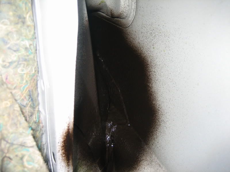

Did you throw some rust converter on the inside of the panels? Makes even a bigger difference than I thought—I had body work done before and the metal that had been treated with the stuff on the inside is still like new, the other metal is in bad shape. I use a cheap spray bottle to get in the hard-to-reach spots.
magicmike
Posts: 2772
Location: USA, RI
Post by magicmike »
evolutionmovement wrote:Did you throw some rust converter on the inside of the panels? Makes even a bigger difference than I thought—I had body work done before and the metal that had been treated with the stuff on the inside is still like new, the other metal is in bad shape. I use a cheap spray bottle to get in the hard-to-reach spots.
Yes, I have some of that rust converter that turns black. I am spraying that on the insides and then covering it all up with some undercoating for good measure.

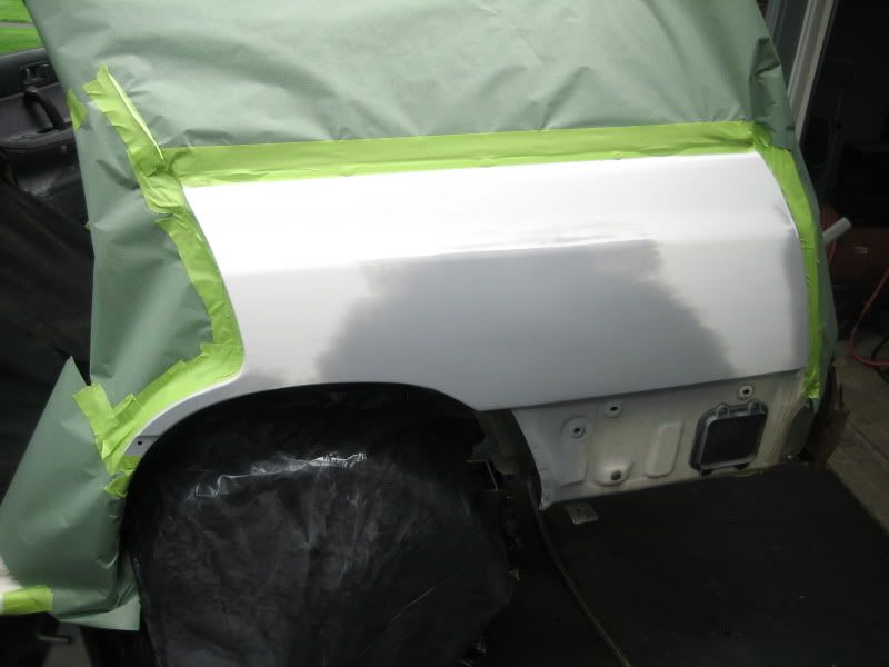

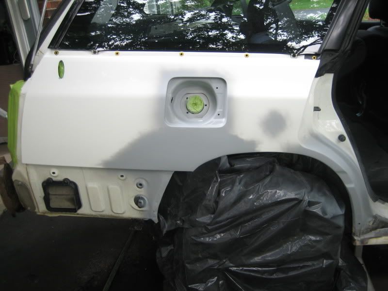

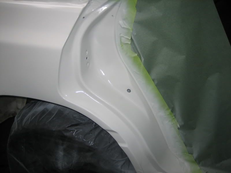

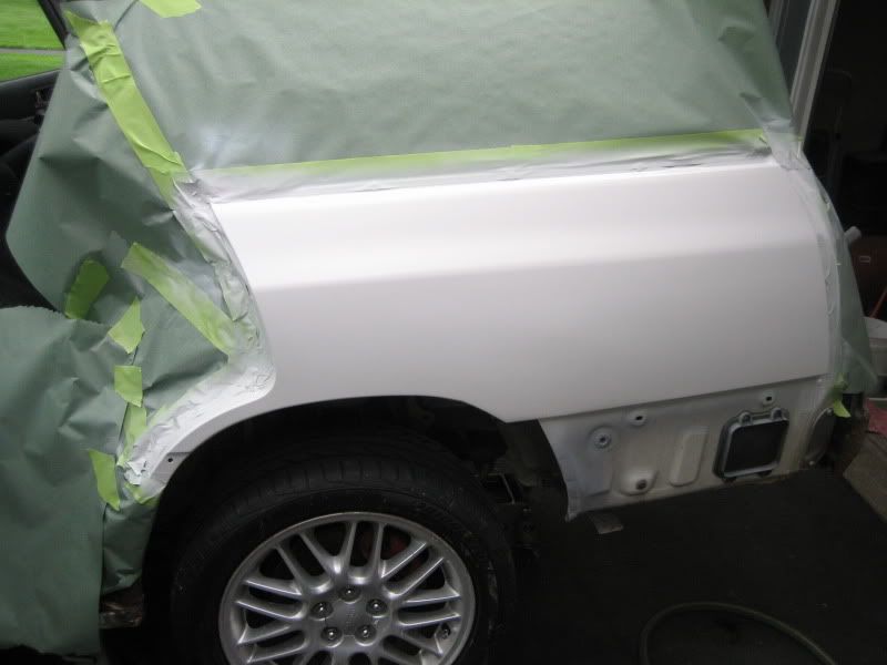

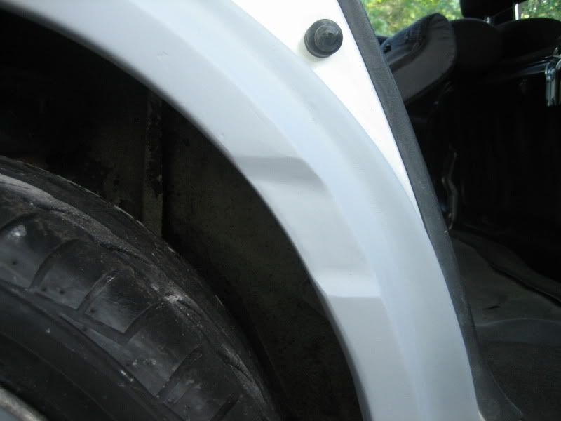

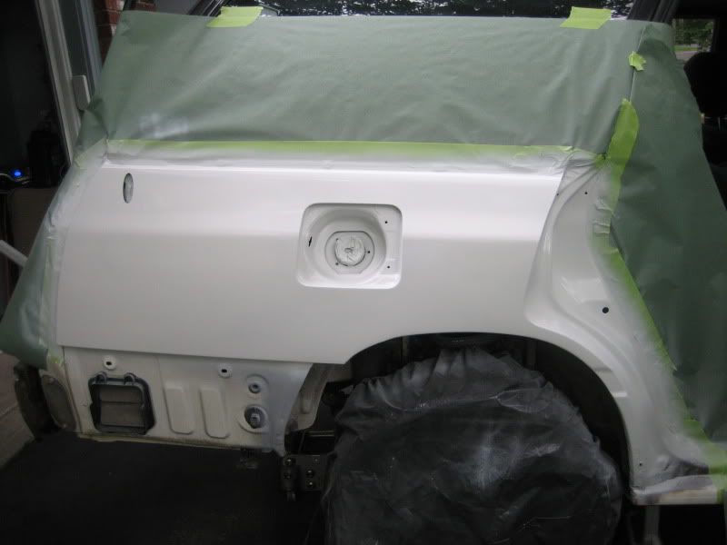

ok, well it rained all day yesterday so I wasn't able to work on the car. I got both rear quaters painted the day before yesterday. I went a little overboard with the passenger side due to the previous bad repair. Who ever did the past repair didn't remove the power antenna trim or even the gas cap. I figured I would do it up and while I had the gas door off I smoothed all the panel seams in there for that custom look that no body will notice unless they are crazy like me.

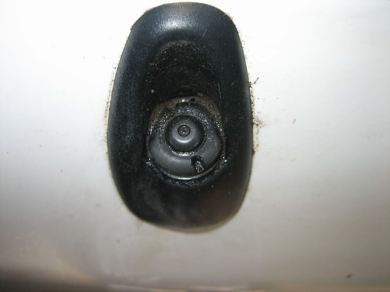

Here is where I started:

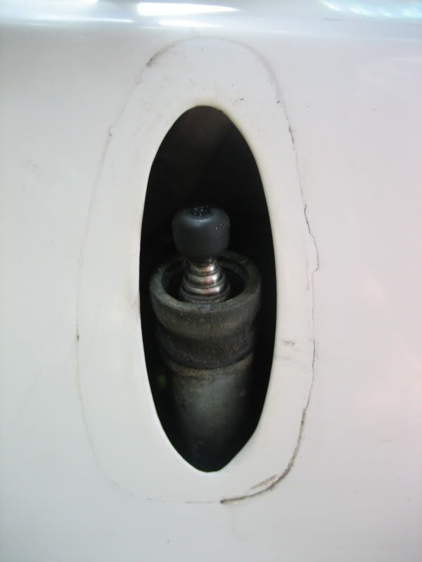

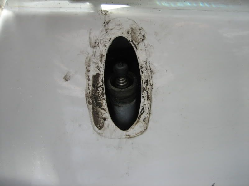

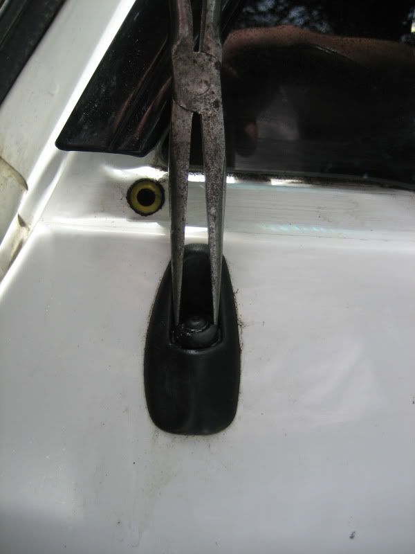

Went and grabbed my VERY expensive snap on antenna nut removal sockets (left over from my installing days).
none fit :roll: used my job lot 3 dollar long handle needle nose pliars.
This is what I found under it:
you can see the built up clear coat around the edge:
After wet sanfing it smooth:

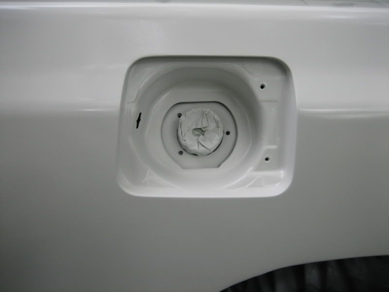

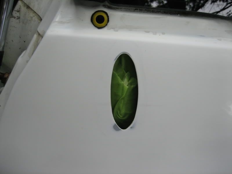

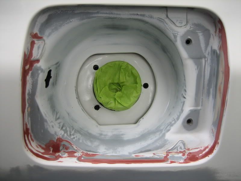

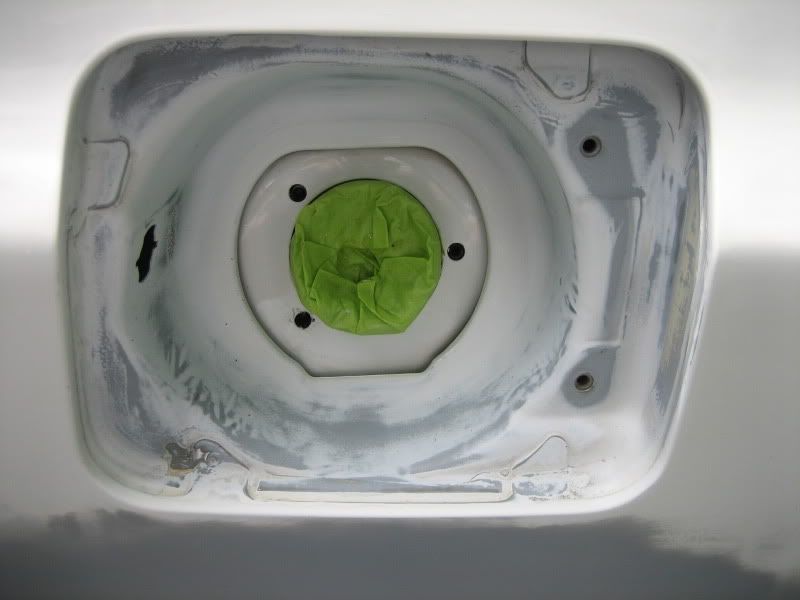

Now for the fuel door opening:
After some filling:
Primed and ready for paint:
Painted:
You can see I removed everything (i.e. latch and door switch, interior panel that wraps around).
Drivers side primed and ready for paint:
Painted:
Next step is to mask off the finished areas and spray undercoating everywhere hidden under the bumper cover. Then i'll put the bumper cover back on and I can start driving it again :)

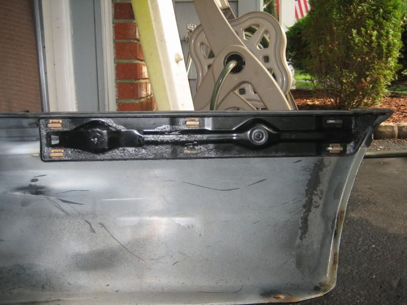

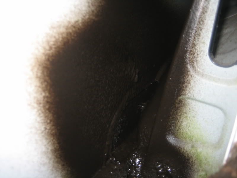

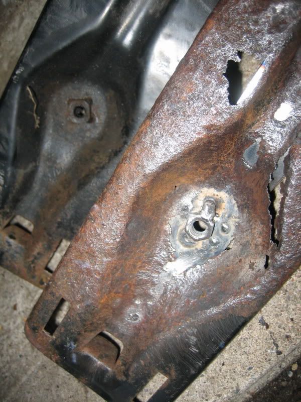

I sprayed the insides of the rear quaters with rust neutrlizer and then covererd that with undercoating just to cover it up good.
Drivers side:
Passenger side:

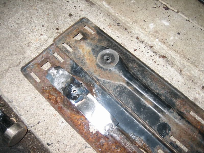

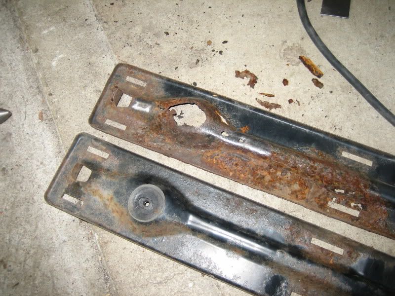

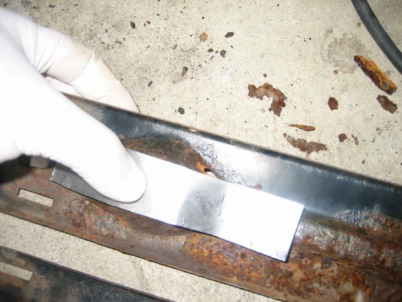

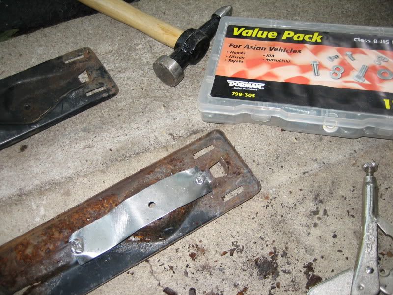

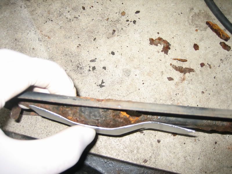

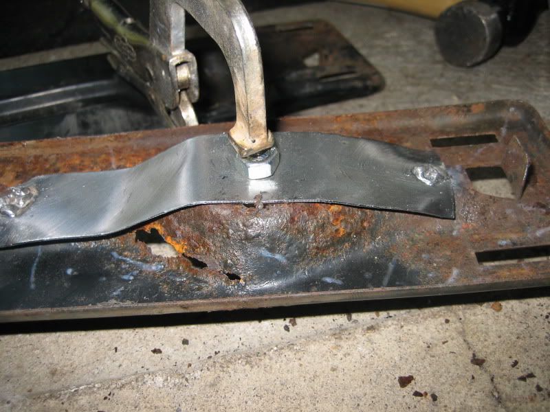

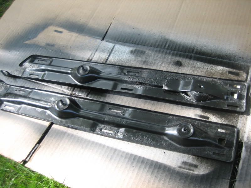

Now to get that damn bumper cover back on. Oh snap! I forgot that one of those pain in the ass metal supports on the sides was rotted through.
Break out the metal:
A little welding to hold it on:
Oh yes, I need a nut welded on there too:
I actually have the nut on the wrong side and welded it there too. I had to grind it off and weld it on the correct side :)
After rust inhibitor and some black satin paint:

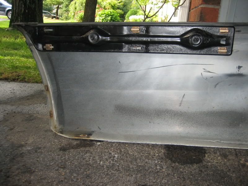

Installed with those clips on the bumper cover:
So here you go. Bumber back on now:
I didn't take photos of the obvious plastic clips that hold the cover to the metal bumper itself.
In hind site, I would not have removed the cover but rather just taken the whole bumper right off as an assembly. It would have been far easier.
