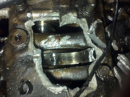

Making some progress. Wound up pulling motor again to remove oil pan and pickup and inspect; Screw fighting with that damn thing underneath the car. The pickup itself looked fine and the o-ring was present; tiny bit of RTV showed up in pickup screen so now it has me curious. No serious metal shavings or signs of issue with the bearings; Still looks pretty.
Probably going to pull the oil pump next and reinspect. I may just replace the oil pickup and oil pump if I can find some reasonable prices. This has also taught me a good lesson about taking apart your daily driver. Soon to be remedied.
Progress has been slow as I have began working quite a bit more to bring in some extra cash; Distracted by a few other Legacys too.
Also:
Don't drive with rod knock, or suspected rod knock! Began teardown of blown motor we got with a shell. Extra 128k mile motor is being gone through to drop in the clean sedan shell. I'm kind of paranoid about driving that thing.. The interior is too clean.
Subaru-less
Posts: 27928
Re: randomiams 1993 Legacy SS with bonus TW action within!
randomiam wrote:Image
Ouch!!

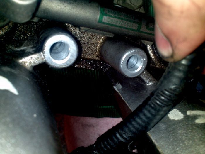

I'm pretty excited to tear it down and examine things further. Subautopsy. I have discovered a few odd things. The oil pan on that motor was somewhat different; The pan itself has some extra internal stuff going on with it-- difficult to describe, so I will take comparison photos and include them on the next update. Bit curious if said oil pan might not have helped contribute to the disaster
Also: I'm not entirely sure but I have noticed that the intake manifold off that motor is different than that of the other two in that it has a raised inner mounting bolt setup -- It's as if its cast differently.
Looking at the service manual it looks appropriate but my other two intake manifolds do not have this raised portion and use different length bolts.

Posts: 27928
Is that pic where the fuel rails bolt to? I think some of them were different, but I don't have the details as to when and how exactly.

That's right next to the fuel rails, where the intake bolts onto the cylinder heads. It is a bit strange.. Wonder why it changed.

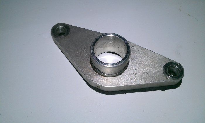

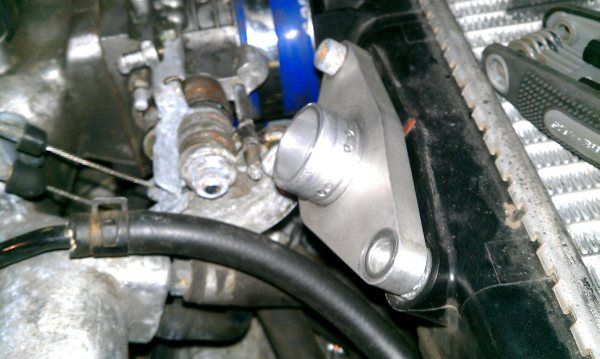

What do you guys think about possibly adapting the outlet of a functional blow off valve to a hose to recirculate vs using a stock BPV? I'm not confident that this current setup is holding the pressure that well so the point may be moot but I'm just kind of brainstorming. This is all off of a 2006 top mount.

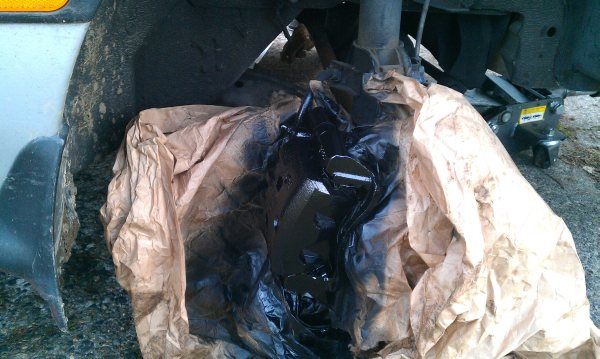

work in progress, turning the stock calipers into a slightly less rattle can white:
