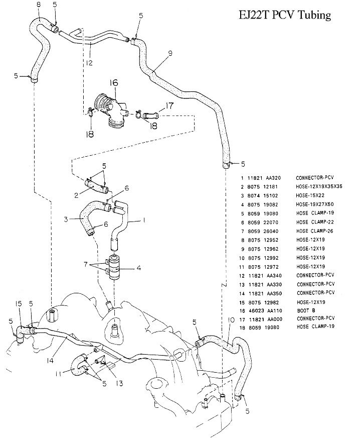

The PCV system should be plumbed correctly, I followed this picture:
I also read your post on the PCV system this morning that I found interesting as well: http://bbs.legacycentral.org/viewtopic.php?f=5&t=50906
I think the reason for that much oil from PCV is either from the rings breaking in and and there's a lot of blow-by from it, or it's because one of my PCV hoses from the heads are cracked (hose #8 at the head above).
