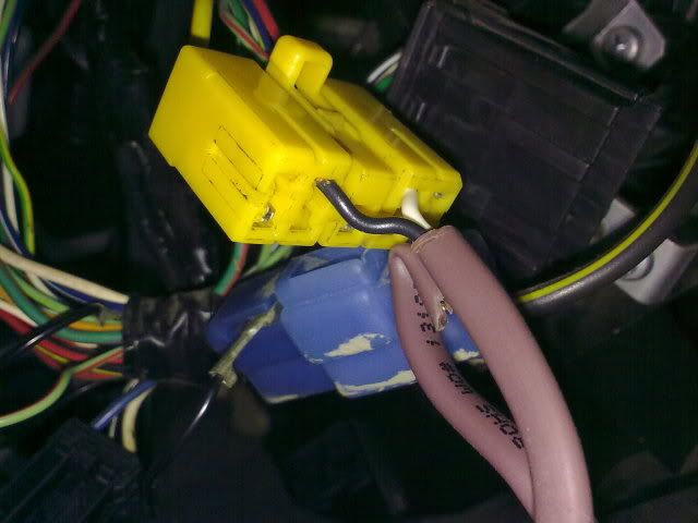

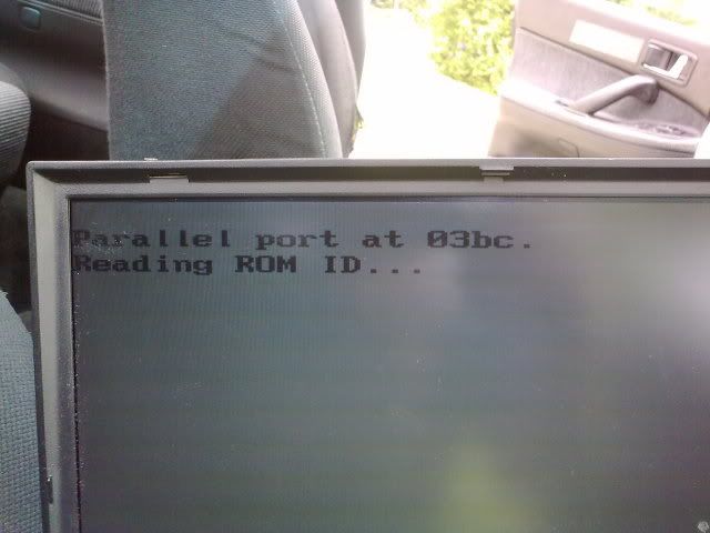

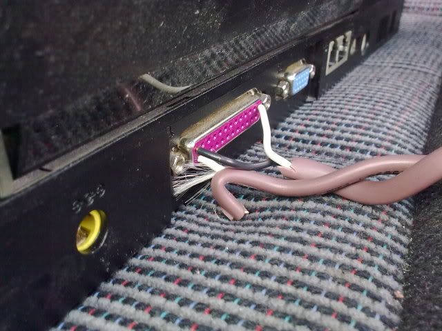

I am not sure if hooking things up like this work. So I tried lol. Just says reading rom? I am thinking maybe the wire doesn't make contact at the computer end. Should I go buy a female end parrel port? Or am I just doing this all wrong?
Oh and I am reading through your thread vrg3. Seems like a few people had the same issue. Another 10 pages to go!!!
got it working. What a awesome program. Been testing the car for a bit now driving around yet no overheating and fans cycle. How does it measure boost and vacuum ? It does show timing correction as high as 4. Once i fix all my vacuum leaks i will see how things run. I havent driven the car very continuos. Seems like if i let it idle till it is at operating temp its fine. Regardless very cool app thanks alot vrg3!
