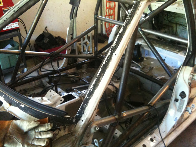

nice fit on the A Pillar. is that a kit? is that a hydrolic handbrake i see?
i am looking to prep a car for some regional club rallies in MN. probably a 90 FWD legacy (or impreza if i can find a cheap enough one) for G2.

No on the kit, yes on the hydro handbrake. Cage is by me entirely. It's my first attempt and so far it's good. I plan to have it logbooked this weekend actually.

biggreen96 wrote:No on the kit, yes on the hydro handbrake. Cage is by me entirely. It's my first attempt and so far it's good. I plan to have it logbooked this weekend actually.
not your first time with a welder, is it? the cage looks good so far.

Definitely not the first time with the welder, but first humongous project with it. I've had the thing for a few years now, a Lincoln precision tig 185.
Re: Teaser pic of the rally car.
Did you remove the roof panel to fit/weld the cage?

Nope, cut holes in the floor. Dropped it down more than enough to get to the welds.

biggreen96 wrote:Nope, cut holes in the floor. Dropped it down more than enough to get to the welds.
That's what I thought, the plates look just like mine. You must have seen the same article in Miller's website.

Good news, the car is now logbooked!
What does that mean? Passed safety inspection?
biggreen96
Posts: 961
Post by biggreen96 »
The cage did, yes. I had never done a cage before, but my welding is good, so I'm in business.

F'n sweet man! It's cool to see someone really take hold and move forward with a project like this. Well done on the chassis and cage too - I know many of those certifications don't come without a fair bit of scrutiny.

Really went all out on that bracing. Nice.
that cage is badass

Last night after work and tonight after work I fabbed the selt belt mounts.
Inboard belt mount on the trans tunnel
Anti sub belt mounts.
Shoulder belts.
If you notice the cut on the mount there is wavy, it's because it is. I built the cage and all the plates with a fucking ghetto ass sawzall and shittttty Harbor frightening tube notcher. Though you can get surprisingly good cuts if you clamp a straight edge to your piece and be diligent about it. The notcher is crap and barely made it through the cage. It's going to the heap.
