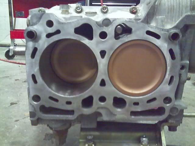

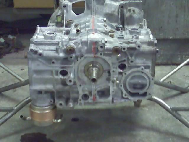

Well the short block bits are back in my possesion from the machine shop!! Block is bored! rings are gapped! All bearings are clearanced.
now about that last photo.... Has it ever happened to you? You know you have all these sweet parts and 8 free hours... you get every thing cleaned up, lubed up and.... half of the bolts for your block halves have apperntly walked out of the bag you were keeping them in? I guess they just got tired of waiting after 20 months. Time to order some new ones :roll:

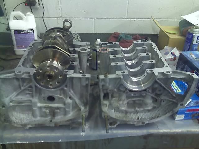

Short block is together!!! and everything is that really good tight but really smooth/free spinning feeling this week i am going to finsh sticking on my oil pump and oilpan and oil cooler.
Has anyone really had a problem with the 22t oilpump not being sufficient enough? Would it be worth it to go up to the new 12mm oil Pump?

Posts: 27930
From what I heard, the 22t oil pumps are fine, and actually have a higher pressues relief valve setting due to the oil squirters.

Looks GOOD!
I also heard that the ej22t oil pumps had higher than normal capacitiy, due to the turbo / oil squirter / hyd lash adj application.
Not sure how true that is, but it sounds reasonable.

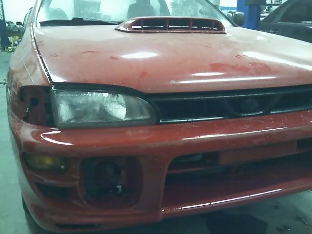

Well my turbo and header are on the way. Pics early next week.
Front bumper painted and installed.

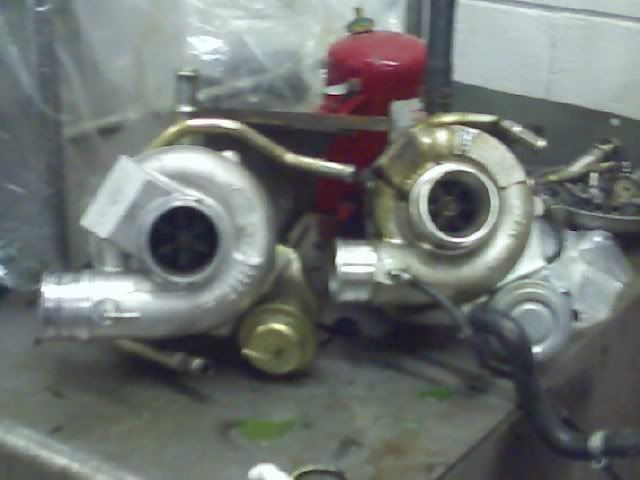

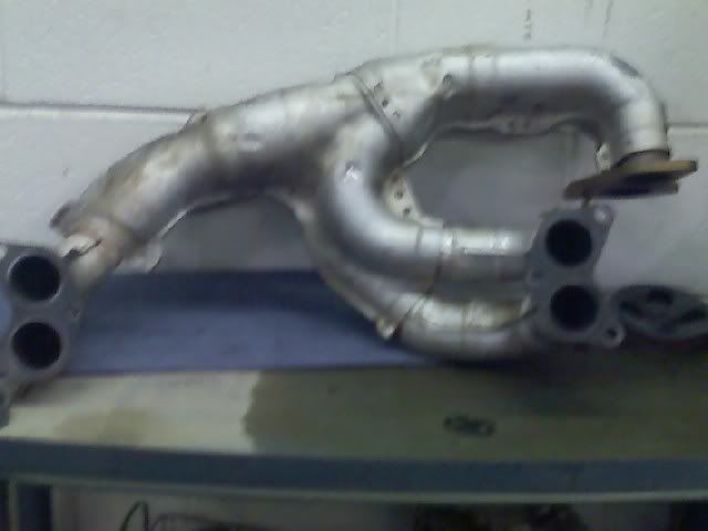

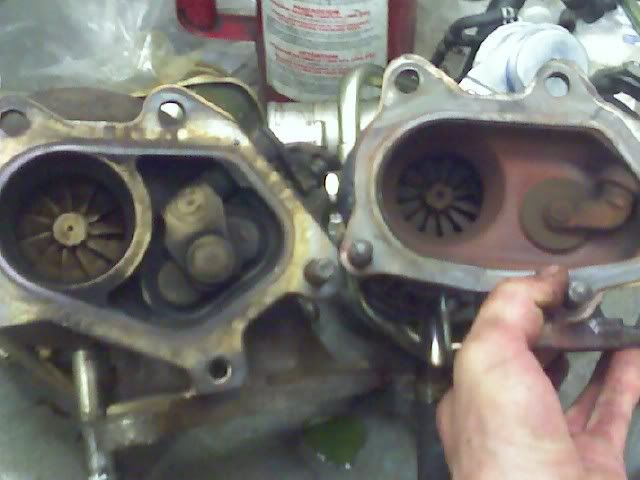

At any rate, my birthday is thursday but my presents to myself arrived today!!
Twin Scroll Spec C header
Vf37(next to td04 pulled out of a Baja today)
Turbine side VF37-Td04
Inlet side Vf37-td04
So any money I get for my B-day will be used to ship these out for porting and ceramic. From there I have to figure out a downpipe, Order a clutch, Acquire an sti intercooler. Oh and I swear the heads will be back soon.

Well I got some more toys this past week.
Bumper and grill are on:

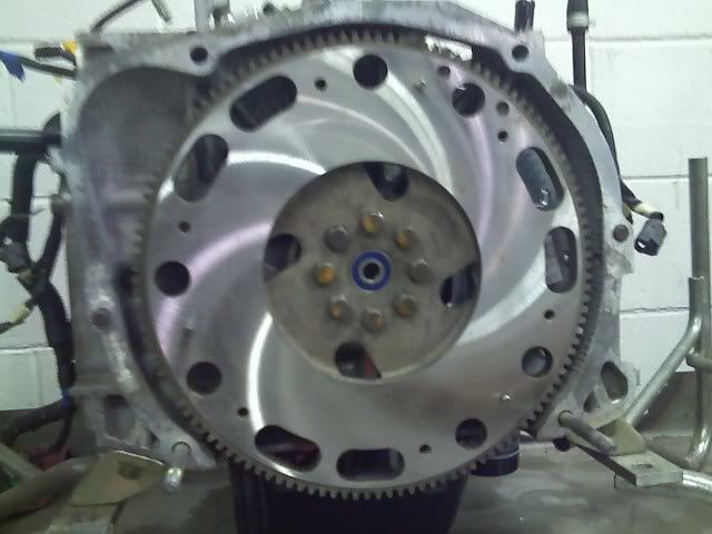

Flywheel I picked up from Legacy294...about 15months ago

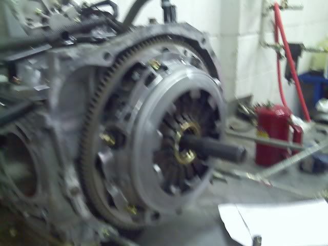

STI Clutch disk and Pressure plate

Post by Arctic Assassian »
That flywheel looks baller! Too bad spock hasn't unleashed his secret transparant aluminum formula yet... (for you trekkies)
