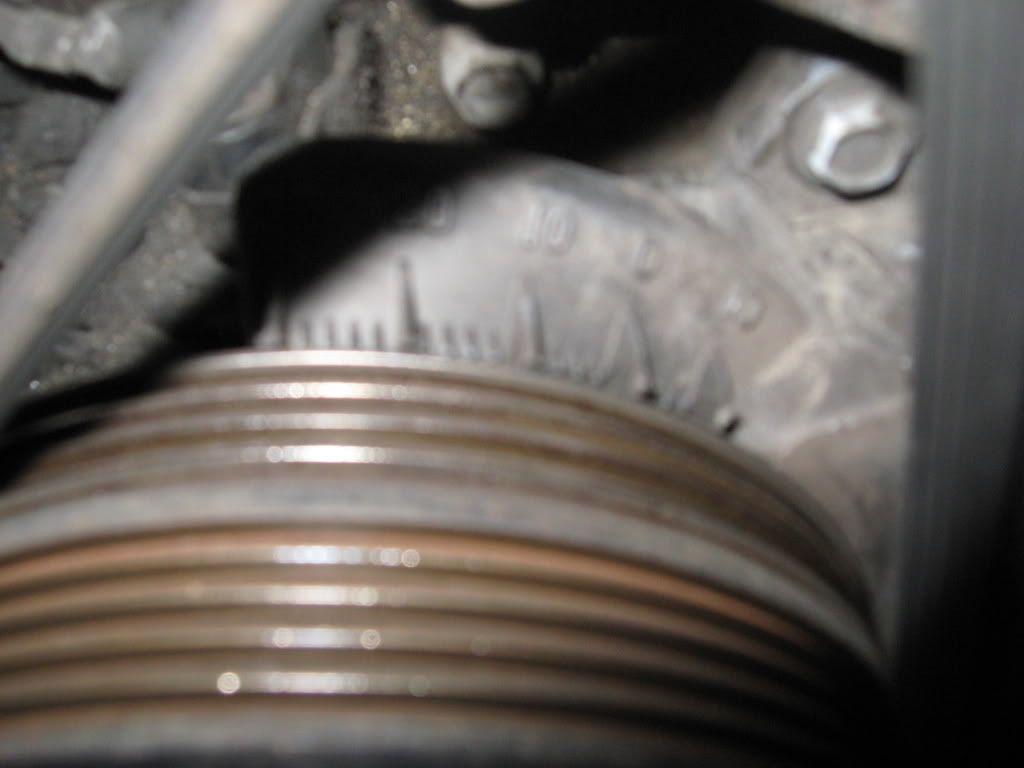

Don't worry about TDC, just rotate the crank so that the | mark points up and see if the cams' | marks also point up vertically. If they don't all point up, your timing is off. Don't worry about the painted lines on the belt, ideally the mechanic used them to line it all up easily, but that's assuming too much and the engine doesn't care what's painted on the belt as long as all the | marks on the pulleys are aligned vertically.

Ok so the cams and the crank marks all have to line up. Now my question is how do I observe the crankshaft mark? IS there a mark on the pulley on the end of the crankshaft? So to check the timing do I have to take the center cover off or can I observe it with just the cam covers off?

There is a mark on the crankshaft pulley the will line up with the Timing marks on the center cover. The cams line up with the notches in the back of the timing belt cover on either end. The crank should be lined up with the "0" mark (SEE PHOTO) and then the cams should both line up with their respective notches.

I wouldn't recommend using the pulley for checking the timing. Pull the pulley & center cover off, and check the mark on the crank gear. You want to use the mark on the back of the gear, not the one on the front.
Here's a pic

Thanks for the pics guys. I think it should be easy to check now. What about the crank pulley? Does it just unbolt? Thanks.
Posts: 27928
Yup, just unbolts. However it may be a pain to get undone. If you have a manual trans. Stick the car in 5th, have someone stand on the brakes, while you break it loose.
On an auto trans car, you need to stick a breaker bar or pry bar in the back of the flex plate through the access cover in the passenger side of the engine bell housing. This will keep the engine from turning over while you loosen the crank pulley.
When you reinstall the crank pulley, it needs to be torqued to 110-120 ft-lbs. Almost all the manuals have this incorrect which leads to the pullies coming off and screwing up the crank keyway, pulley, and sometimes the crank.

Ok so I haven't had much time to do anything with the car lately but I did have a chance to look it over real quick. I didnt have time to take off the crank pulley and line the crank notch strait up, but I did turn it until the pulley line was pointing up. What I noticed was that the left side (looking from front) cam pulley was strait up also, but when I looked at the right side one, the notch was 4 to 5 teeths back of the crank and left side one. Even if the crank pulley wasnt showing the correct timing, wouldnt the two camshaft pulleys still be in alignment?
