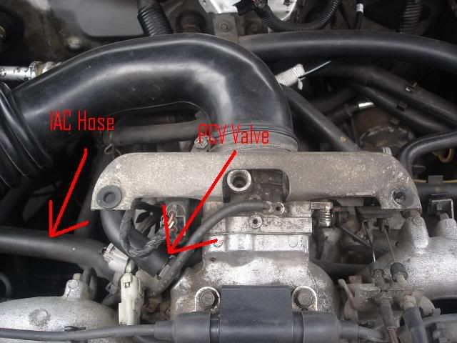

Low idle fix, cleaning the IAC valve worked for me, just spray IAC safe intake cleaner down the IAC (idle air control) tube. It is hooked up to the intake, you will need to rev it up when you unplug it, or you can just fill up the tube full on intake cleaner, plug it back in, then start it up and rev the engine up, let the rpm's fall, rev up, and repeart like 3-5 times till it seems pretty good. Also a good idea to actually unplug the intake from the throttle body and cleaning inside the throttle body with some intake cleaner. When I took off my intake it was pretty dirty in there.
Subaru conditioner.
http://www.scoobymods.com/forums/attach ... 1077312572
Ill find a pic of the IAC hose.
Here is a pic.

Isn't the indicated line the same as the PCV line? I got a PCV valve and have yet to install it. I generally use the brake booster line and some carb cleaner with a tooth brush to clean the TB. I checked and this one is filthy.
In the past I've often removed and disassembled IAC's to clean them - Is this one internal?

The PCV valve line is different. I have a pic. You can take apart the IAC valve, but some people encournter more problems usually after disassembly. Easier to try spray down the tube. Carb cleaner can work down the IAC valve as well I would think. PCV can help with oil issues too.
I'd suggest using the PCV for seafoaming. it's centrally located.
Also, I'd HIGHLY recommend NOT cleaning the TB. That is a sort of sealant of some kind, and some TB's, they have a bypass. Cleaning this sealant allows for more air to bypass the throttle plate and causes a high idle. Your 93 probably doesn't have the bypass, but I'd still probably suggest leaving the TB alone. Here's some back info/threads and pics.
