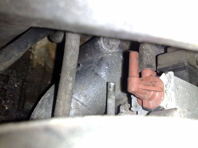

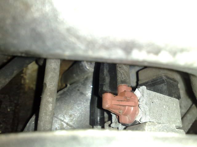

Hey guys. After I replaced my knock sensor my check engine light went out which was great. My dad came and looked around the motor. He found a broken vacuum hose right here.
I should have took pics before taking off the hose to show you how it broke. Looked like it just cracked and it was basically leaving a huge hole definitely no vacuum. Got a vacuum hose and popped it in.
Idea of this thread was to find out if other people found the hose that goes here cracked and what exactly it is for.

hum, you should have been throwing a code for that. thats the pressure exchange solenoid and that hose rund to the pressure sensor. Should get a code 45 if thats not right. you see a noticable difference with this connected no?

Well what kind of noticeable difference? Also there was no check engine light when I was driving to the store to get the hose with it completely off. I took a long drive and according to the gauge which is usually pretty accurate, i am getting about 550-600km per 50L. Was running pretty good. The car needs new plugs and OEM wires, right now it has aftermarket wires. Didn't really notice anything though. Maybe fuel economy if anything.

Posts: 27932
That is the canister purge solenoid, not the pressure exchange solenoid.
The vacuum line connects the solenoid to the hard line which goes to the charcoal canister in the front of the car.
With that open like that, you have the potential to run lean since at cruising speeds the solenoid opens.

Legacy777 wrote:That is the canister purge solenoid, not the pressure exchange solenoid.
oops you are totally right, my mistake, I see now what your talking about, the picture was so zoomed in that I was confused about the location in regards to the engine compartment.
