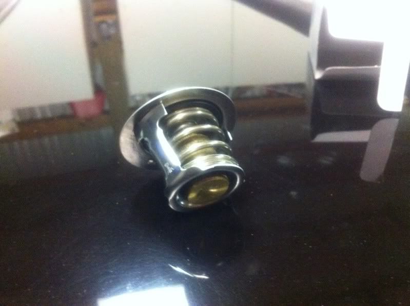

The thermostat was bad so I picked up an OEM one.

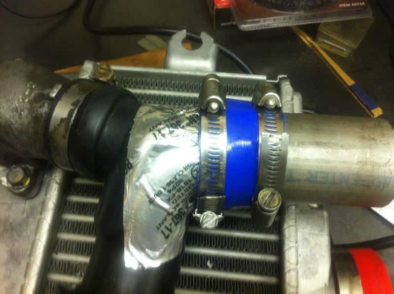

The y-pipe I modified.

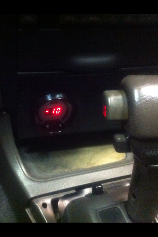

I installed the AEM Tru Boost gauge/controller.
Has a really rough car shaking idle thanks to the Delta 230's

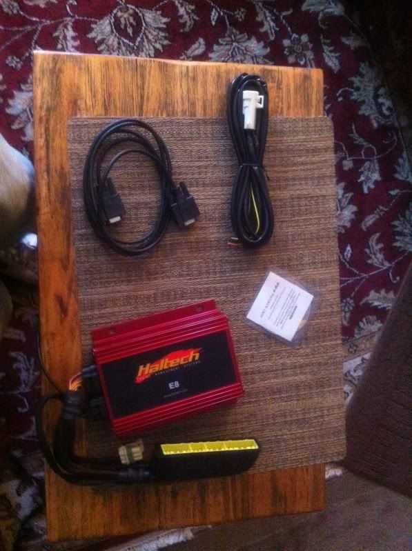

Haltech E8 engine management that I plan on installing whenever I get the chance.
