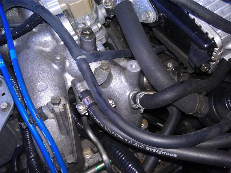

Just sucked about 8 or 9 oz of oil out of my engine and replaced it with a half can of sea foam. I would like to seafoam the intake but it's looking a bit difficult to do. The PCV valve is inconveniently located directly below the throttle body so in order to get to it (I bought a new valve as well) I will need to remove the intercooler, replace the valve and put a long hose on it and then install the intercooler again and do the sea foam. Then attempt to reinstall the crank case hose with the intercooler on.
Does anyone know if it's safe (or even effective) to pour sea foam in the intake before the turbo? There's a VERY easy to use nipple on my silicone intake.
First pic is the vacuum ports on the top of the manifold. There's 3 and they're all at the front so I don't think the rear runners would get their share if any and they're on the sides right by the runner so it could all go into the runner that it's closest too.
This is the nipple I would like to use but don't know if it would be safe or be as effective because it could pool in the inercooler or associated piping and also it would probably dilute it so maybe it won't be concentrated enough to work properly? I don't know.

I wouldn't pour sea foam in before the turbo or intercooler.
That's what I thought. Bummer.

Yeah, you want to feed the Sea Foam into the intake downstream of the throttle body so engine vacuum sucks it up. You should be okay with one of those nipples on top. Even if the flow is uneven (and I don't think it actually would be that uneven), as long as you use enough Sea Foam, it's not a big deal if the front cylinders get a little more than the rears. You could also use the nipple where the brake booster hose attaches. Or pour it into the IAC valve inlet, cleaning the valve at the same time.

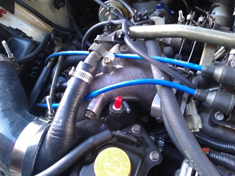

The brake booster hose is down the number 4 intake runner past the IAC valve. I don't see any possible way that would feed any cylinder other than #4. PCV valve is the only place that's centered and it has to be replaced anyhow so I think I'll try that.

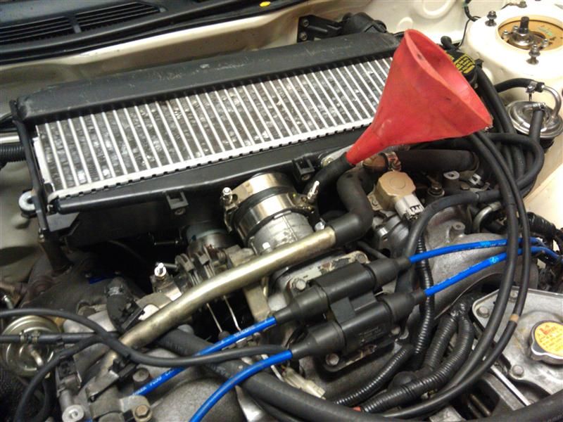

I pulled it off via the PCV valve after installing a new one. Old one turned out to be fine but I replaced it anyway. I had to remove the intercooler and replace the valve and then fit a hose to it and reinstall the intercooler. Poured in half a can and as I was doing so I noticed smoke coming up from the left side of the engine. Jacked the car up and found out my header collector to up pipe gasket is blown. Bolts are wicked tight and I could see nasty colored liquid seeping out of the bottom of it and turning to smoke. I'm very glad I sea foamed my engine! Never would have known as it was inaudible over the rest of the exhaust.
I am also glad I did this because I found out my PCV system was leaking terribly which is why I get an oil/fuel smell all the time. The hoses I used were tighter than a nun's cunt when I first put them on so I didn't think I needed clamps but now they were so loose they would have fallen off if there was more room for them to slide and oil was coming out the ends. Replaced the hose with what used to be either a coolant hose or a brake booster hose and put hose clamps on it. I'm a little worried about the hose holding up over time because it probably should have been a hose specifically for oil and fuel but at least it has good clamps now.

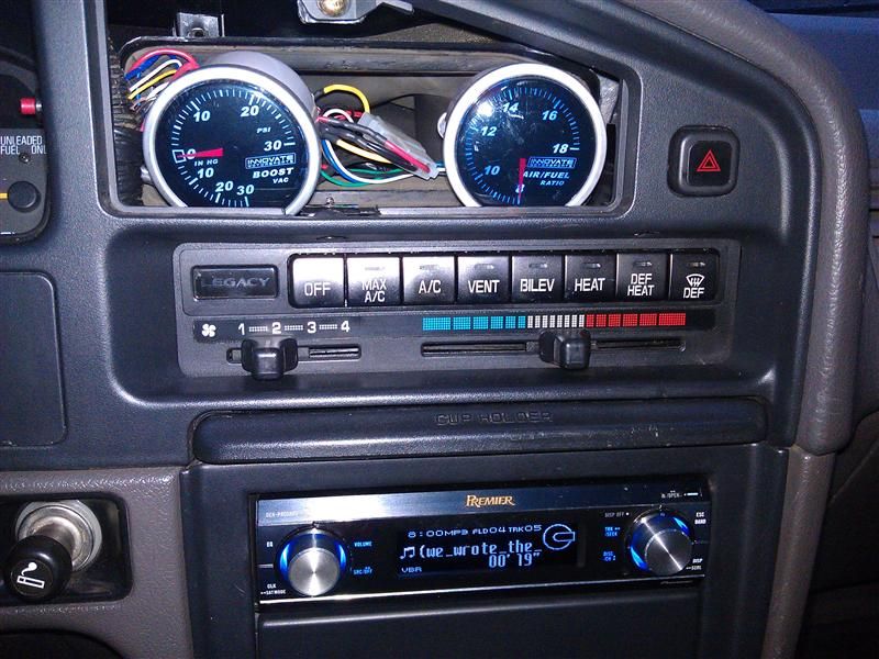

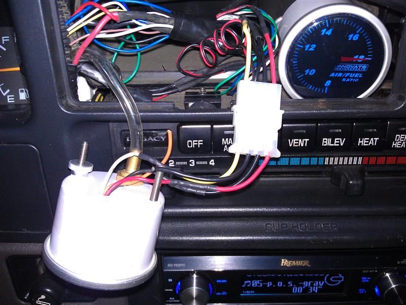

I also finally got around to moving my gauges to my center vents. I have a good idea of how I'm going to finish it off but for now they're relocated and I wired in pair of connectors on the boost gauge because Innovate are idiots and they decided it was a good idea to have a built in connector on their AFR gauge yet it apparently wasn't necessary on their identical boost gauge. WTF Also, the AFR gauge only has one color, white, but the boost gauge has white and orange. WTF?!??! It's the same series of gauges made to match and I'd much rather run the orange which not only looks better but is easier on your eyes at night. Oh, and one more gripe about them, one is white and one is a blueish white. It's clearly a different color!!! I guess that's what you get for buying cheap ($80 a piece) gauges. Other than that they function just fine and look good but I would prefer the ring around the glass (plastic) was black rather than silver.
I found out the strut brace makes it impossible to remove the intercooler so it has to come off first. Small pain in the ass. I was halfway through sea foaming the intake when I noticed the exhaust leak and jacked the car up and I didn't remember the nuts were still off the strut top bolts and the wheels suddenly gained 3" of suspension travel! That was fun. I had to grab jack stands and set the car down so I could use the jack to jack up the wheels while I guided the bolts into their holes. Lesson learned, always put the nuts back on after removing the strut brace.
kimokalihi wrote:Other than that they function just fine and look good but I would prefer the ring around the glass (plastic) was black rather than silver.
Paint 'em.

I'm going to paint those gauges. I doubt the rings separate so it might be tricky.
