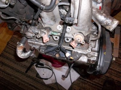

so hear is the current situation with the legacy, about 2 weeks ago i bought a 91 ss from craigslist for junk (300 dollar car LoL lucky me !) ... i have a 94 ss i bought a few years ago with the intentions of fixing it up for a dd, but the cars auto and she's got lots of issues. Problem for me is that i was expecting a parts car but i want that to happen hear. i am broke as a joke atm so i need to get things going a cheap as possible but the car is 1.5 hrs away and the valves are bent from a time belt failure. i put this engine together and atm i dont have the funds to buy any parts i have tons of subaru bits kicking around tho. i am going to bring a buddy with me and install where the car sits and drive it home, but its been sitting for the past 8 years in the last owners garage and i can't drive there more then 2 twice i figure.
i have a 04 sti and a wrx motor's kicking around will the injectors work from these cars
i have the 22t fuel rails but the dont seem to have a good way to fasten down to the heads
can i just wire up the new style coil in place of the old one.

Just an FYI, you need to copy & paste the links associated for forums so it shows up correctly. I've fixed the pictures in your thread. There is a small icon to the uper left corner of the picture that will have several different options to get the correct url to use with the image bbcode.

If the WRX and STi motors you are referring to having access to are USDM, then you can use the STi fuel injector but you have to get a set of rails for the heads (25D fuel rails). The WRX is top feed from 02-05, and I think side feed on 06-07 (not 100% sure on that).

i placed a order on ebay uk for a set of 440 injectors and a ecu from a 93 ra. i guess my new place is to get it going and build from there i am hoping to run this set up for the winter and then switch to the 550 rob tune. i have a vf39 turbo that i am going to be using with this. I figure its going to be about 2 weeks before progress, looking forward to it
thanks for the help guys Cob
Re: dohc swap issues
k guys i moved my car to my buddies house - placed the motor in the engine bay on Friday and the goal for tomorrow is to
1. get the intake manifold installed (if i can find my crossover pipe gaskets LoL)
2. wire in a coil conversion harness that i made over the weekend at work
3. install my new fuel pump
I have a few question's if anyone has any info that would be a great help
A) i bought a silicone turbo intake tube used from 07 wrx -- i was planing on pluming out from that to the jecs maf sensor but i seems like its to tight of a fit under the intake i did see that the ej20g silicone tube was smaller for that style idk if anyone could post a picture of there setup just looking solution
B) with my motor combo it seems that my compression ratio is 9:1 is it safe to shoot for the Rob's 550 tune ?

Take a picture of what you're trying to do with your intake and post it. You may have to do some bending of the fuel rails to make the intake tube fit under there. It'd probably be easier to get some manifold spacers tho. I know you're trying to budget, but it's kind of hard to do with this swap.
You may also get lucky and find a phase 1 dohc intake manifold specifically designed for under the manifold air flow. I've seen a couple lately on ebay. Kinda spendy tho.
