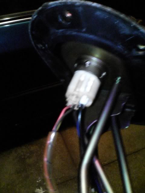

5) Now you see the top of the fuel pump assembly. There are three
hoses going to it and one electrical harness connector. Disconnect the
harness connector.

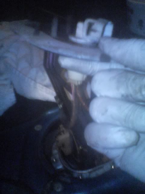

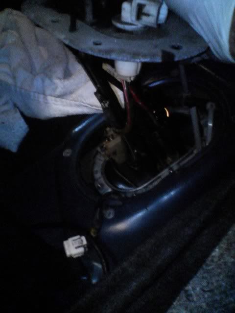

9) At this point you should be able to just pull the assembly out of
the tank. You'll have to do a little bit of maneuvering, since the
float for the gas gauge bends. Be careful and don't force anything. It is just a couple of twists and turns to get it free, remember not to force as it should be easy pulling it out.

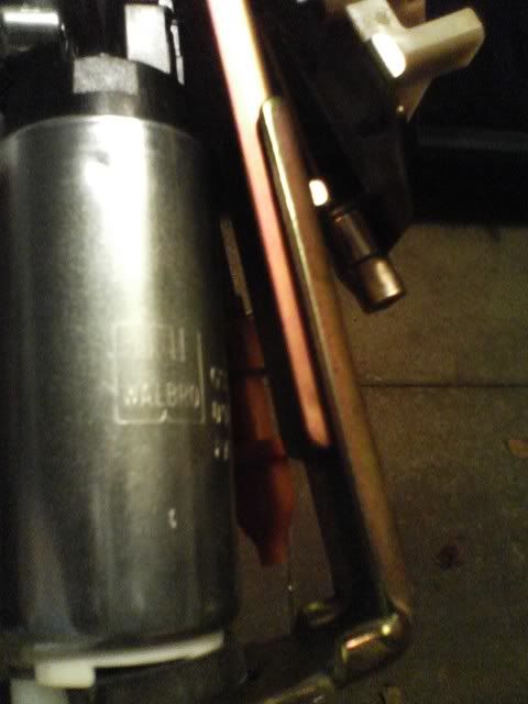

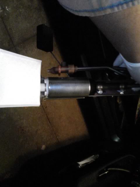

10) Now that you have the assembly out, you have to install the new pump in the stock location. This is actually very easy.

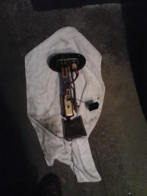

Removing the old assembly from the tank.
Picture of the stock assembly out of the tank.You have to remove the screws holding the bracket to the main housing.
You should then be able to free the pump from the unit after disconnecting the hose and wires.

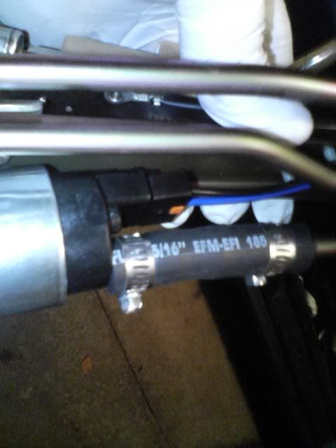

Then there should be a hose that comes with the kit, cut that sparingly but not too long as it will affect the fitting, make it as close to the stock length as possible.
After that just assemble the new unit, it is very easy and straight forward.
Take not of the tiny retaining ring as it is use to hold the filter bag onto the pump.
The new wiring connectors fit perfectly so there is no need to cut any wires or make any joins.
Just reassemble the new pump, the way you took apart the old one.
