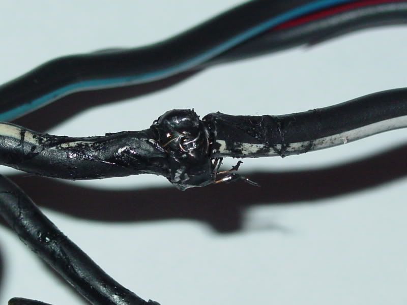

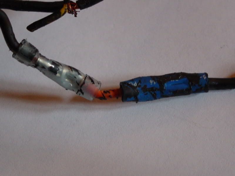

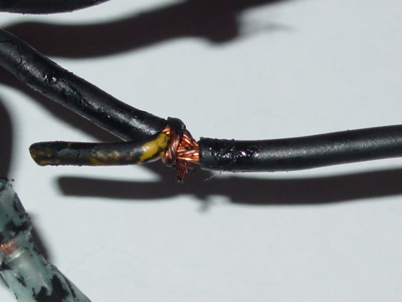

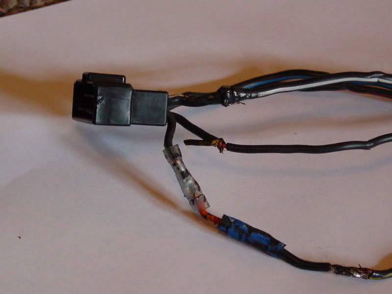

I changed out my ignition switch yesterday, and here's what I found after removing several layers of electrical tape:
Note that the wire in the second pic has 2 crimp-on connectors AND a crappy solder joint, not to mention 3 different types of wire.
I am incredibly surprised that this actually worked, albeit not well......

HAHA! That one wire is *tied* on.
