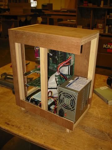

The computer is a full-size ATX mounted in a custom wood case (again, I used parts I had lying around, this is not a perfect design by any means):

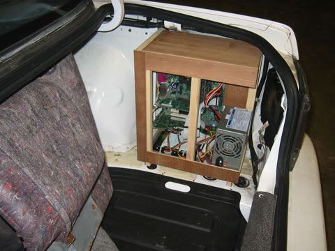

It sits in the corner of the trunk:

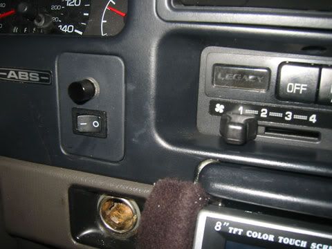

Power to the computer and inverter is controlled by switches in the dash until I can finish a startup/shutdown controller:

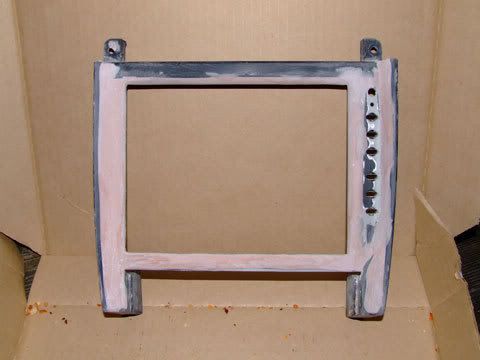

To mount the screen, I molded the casing from the screen into the stock radio bezel using epoxy putty and bondo:
