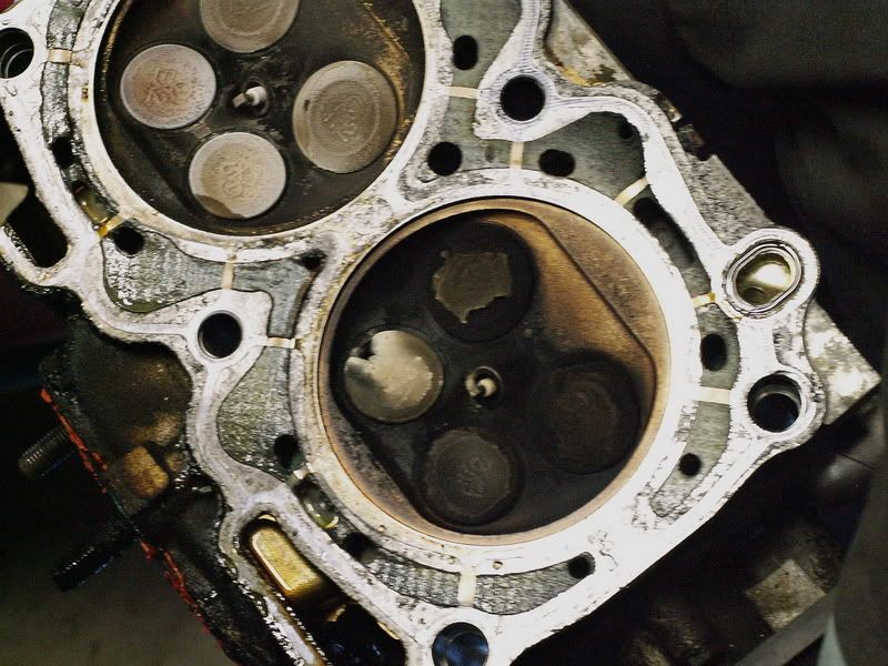

Well, I thought I'd join the cool club and buy a Subaroo, little did I know I bought this instead. . . pleased to say it's all better now, but this is what Nick (555BCTurbo) and I had to deal with.

That's not the fist time I've seen an Ej22 head with that problem.

The car ran remarkably well for only firing on 3 holes :shock:

Same happened to mine. Did over 85 on the highway like that, too.

Ok I'm a bit of a noob when it comes to the inside of engines. The one one the right definitely looks different from the left one. What exactly is going on in that picture? Carbon buildup?

The big chunk missing out of the exhaust valve

Oh that's what that is. All the valves look a little funky on that side. What would cause that?

detonation?

is that cyl # 3, last in line for the stock serial fuel delivery? If so I believe that's what my exhaust valves are starting to look like (in both the 92 and the 94 - havent comp tested the 91 yet) :)

In my case my knock sensor was bad when I removed the engine and since I don't believe in coincidences and my car seemed to be a ringer even on its cheap gas, I suspect a build up of carbon (increased compression ratio) over nearly 1/4 million miles unchecked by the knock sensor did it in. Ran the balls (hard acceleration to redline in the first three gears onto the highway) until the exhaust started making a funny sound off the guardrail. Started to run rough a few miles later. Since it was using oil like mad for several days prior, I think it had burnt a little, but then the cracked or slightly melted part formed a hot spot which completed the destruction of the valve. Mine was cylinder #3.
wiscon_mark wrote:Well, if you're getting knock and you still push it, wouldn't you get detonation?
If you're getting knock you're pretty much getting detonation. Pushing it will make it worse.

same thing with my BD. i bought it like that and drove it home 600 miles.
