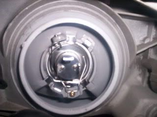

ok, going by the manual it says to remove electrical connector then the rubber boot...the writing on the boot says to >push<..well, i push and nothing happens, what the heck am i doing wrong?

you have to Pull the tab on top of the boot to remove it and then push the clip in and sideways to remove the bulb
[img][img]http://i203.photobucket.com/albums/aa12 ... 0_6591.jpg[/img][/img]

yay! got it...the bulbs were just very stubborn..in fact, it looks like they were the original ones from the factory, which i guess isnt too unlikely as the car only has 96k even though its a 1993..
