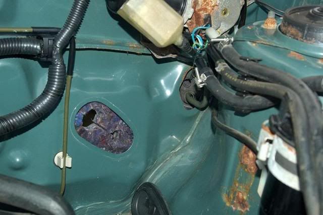

So, took the seat out, started dismanting the dash to see where the most logic place would be to come through and into the engine compartment. Ended up following the fuel lines right the way though, they are roughly the same diameter as the power cable, and there was a space space to go through the rubber grommet thing! Great idea in theory, but damn did it take long to do! I had to take out the glovebox, then the heater housing, just to even attempt to get my fingers in the right place. I then discovered that the rubber mat/soundproofing stuff ran all the way up, and that there was no hole through it. So i tried to make a hole, and succeeded eventually.. I used the Airconditioning (I think) holes go gain access to the back of the heater fan. I then used a bit of wire attached to the end of the power cable, prodded it through the hole, and went inside and yanked the cable through. Woohoo! Victory! After that it was very simple, a matter of manouvering the cable till it was out of sight and not fraying anywhere then I just clicked the cable into the spare slots that were available on the plastic clips for the fuel line.

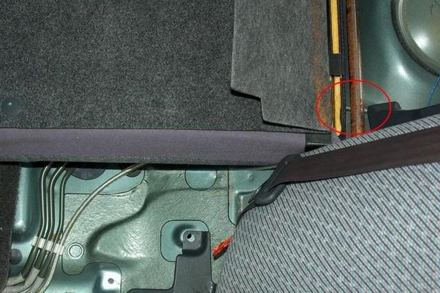

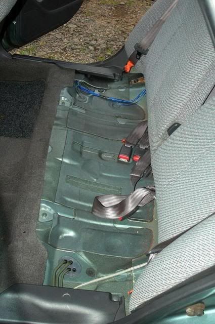

underneath the back seat i went to go underneath the metal pole that is there, so the cable is not clamped at all.

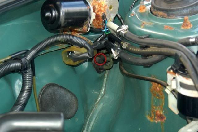

That's the rubber grommet spare bit where I wanted to put the cable.
And This is with the rubber Aircon (I think) grommet removed.

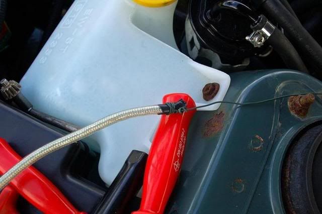

The bit of wire i used to pull it through the Soundproofing mat and hole.

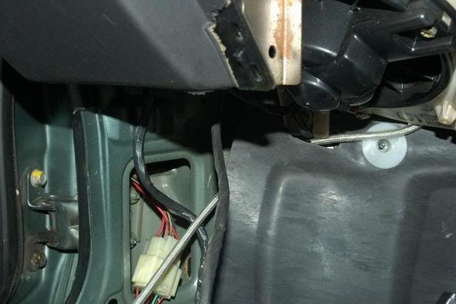

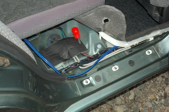

Okay, Inside on the passenger side, (Shortest route from battery to boot.) Fed around the back of the Heater fan, and along the side of the fuel line.

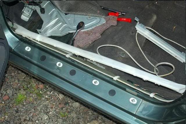

The simple bit of running it along the fuel lines, popped into the plastic connectors.
And underneath the back seat, under the metal bar.

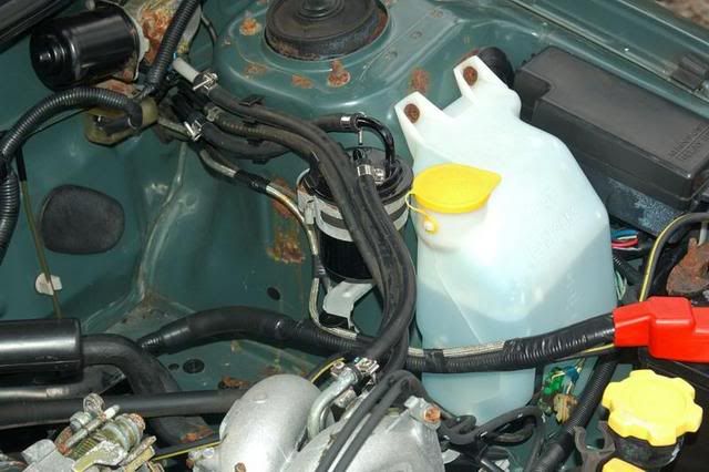

The Finished (I hope) thing under the hood.

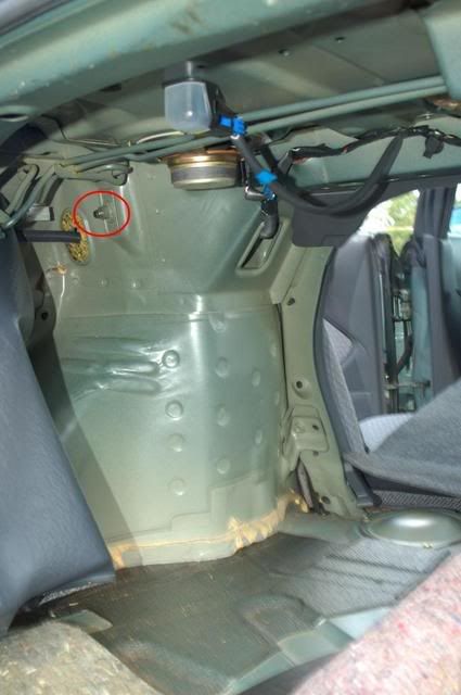

And the bit I plan on taking the negative from in the Boot (What is it for?
