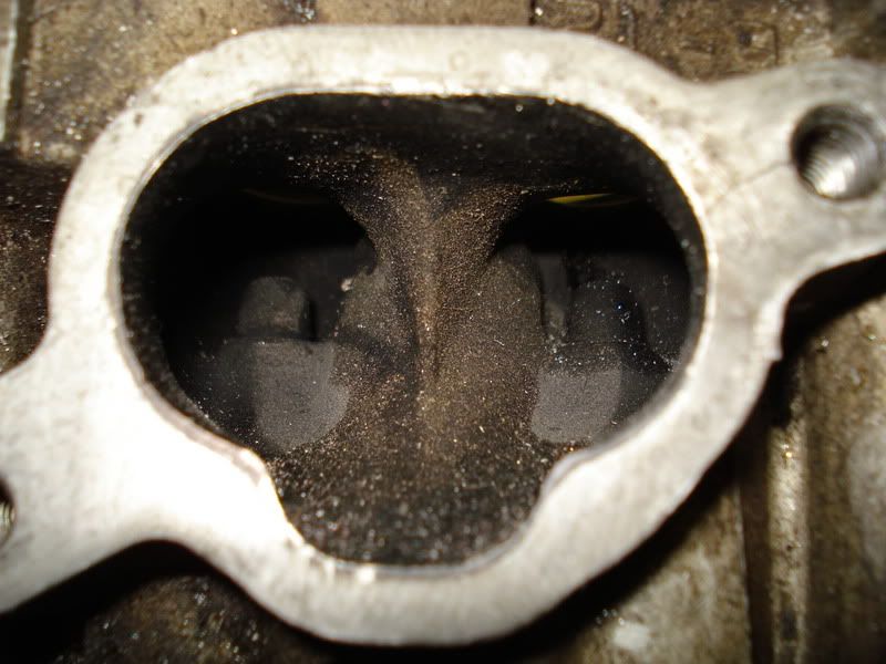

i have been port and polishing for quite sometime. i should have pics soon. doug vincent can vouch for me. i do very good reliable work

unfortunatly i no longer have my camera, and the past 10 sets of heads that i have done have been shipped off without pics.
i have put many sets of heads on flow benches and flow each individual intake port. i have flowed every stage and that i offer. each of which are within 5 percent or less of each other. I no longer put each set of heads on a flow bench due to the rarity and cost of flowing each cylinder. if requested i will flow bench them if it is paid for. after doing this so many times i am able to tell exactly how much material to take off.
im working on getting some pics soon. im even considering going and buy a set of heads and do a P&P just so i can get pics.

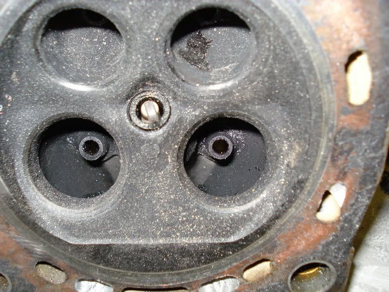

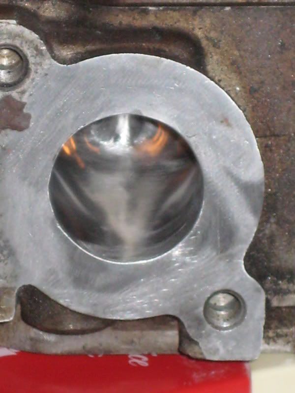

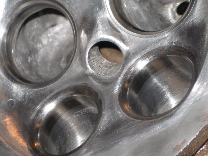

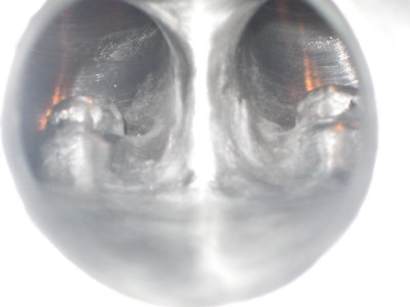

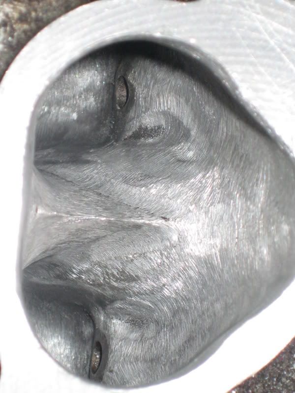

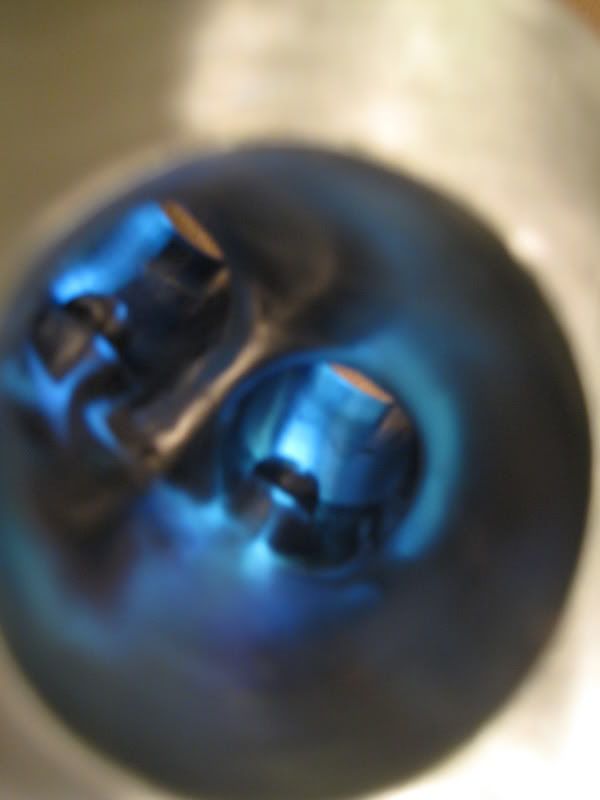

got some pics, as good as they can be. sometimes the flash distorts them too much. the pics are Stage 3
-Stage 2 + combustion chamber modification and polishing
when i get even more pics ill post them

P/P ej22t heads
Is it worth doing a P/P on ej22t heads? If so, to what extent? Eventually I'll get around to picking up a set of ej20g heads but the 22t is being rebuilt soon and that's what I have to work with now.
Jeff
Jeff
'92 Legacy SS ej20g mugged, desnorked, TD04, , MBC, CAI,v2 i/c, JDM STi v2 close ratio 5sp w/4.11's, short shifted.
thehookeup
- Posts: 619
- Joined: Wed Feb 22, 2006 5:14 am
- Location: portland OR
i have done a few stage 2's on 22t heads. Any port and polishing helps always does. They flowed great and seemed to help a little for a stock build. but if you are planning on doing 20g heads on your 22t p & p those heads you would see a bigger difference

But you don't want fuel sticking to the intake wall either.
- Posts: 3335
- Location: Oregon
evolutionmovement wrote:But you don't want fuel sticking to the intake wall either.
True...but I have never heard of that being a problem...
I think Cosworth has the best idea, as they cast in small raised sections in the intake ports of their Subaru heads for proper atomization.
thehookeup
- Posts: 619
no i dont polish the intakes, that can mean bad bad bad news. just porting. gotta leave it rough. i have heard of that cosworth idea, does anyone have any pics?

I wonder if something like a hexagonal golf ball texture would be the best bet. I would think the small turbulence would reduce surface drag and contribute to a smoother flow in the main portion of the manifold. Can't figure if it would be better or worse for fuel atomization. Experimenting would be very expensive. Direct injection would be nice.
thehookeup
- Posts: 619
shoot that golf ball idea could be amazing but your right it would cost so much to test. if it works for a golf ball it could work for anything. physics are physics. keeps it stable and flows well. but i cant imagin the machining that could go into something like that. def a CNC with someone thats a god at the controls. great idea though surely out of my reach

Something like a rapid prototyping process on a plastic that would work in an engine environment might be the only way. Current tests show that it works best on spinning and curved surfaces, so I'm unsure if it would help throughout the manifold (like straight sections). On bicycle wheels it reduces leeward drag (at the expense of a small increase in surface drag) and on golf balls it allows the air to stay attached to ball longer (almost making it act like more of an aerofoil shape that is always correctly oriented to the direction of travel), reducing the separated wake on the ball (drag). So covering a car with hexagonal dimples would only help in some parts depending on the shape of the vehicle since skin friction tends to be a greater problem than pressure differential and the increase in skin friction would actually create more drag. Skid542 could explain this much better.
there is a guy that own's endyne energy dynamics, he used to dimple the intake side of heads for hondas, and it made improvment in fuel atomization.
if i could find more info on this i would post it up.

Endyn does some pretty amazing stuff with Honda motors...they really have chamber design down to an artmgroshong wrote:there is a guy that own's endyne energy dynamics, he used to dimple the intake side of heads for hondas, and it made improvment in fuel atomization.
Like 800whp B18...that's pretty impressive
