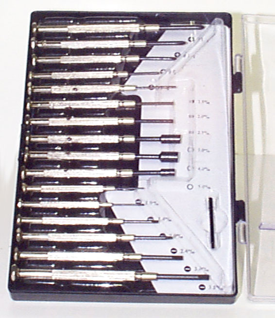

I've always wondered how the dealer removes seals. I have cleaned up quite a Subaru engines and have never found a tool that works as well as a set of small screw drivers with rotating heads like these -
http://www.superdroidrobots.com/images/T-010-016.jpg
One specific size of this screw driver is also the absolute PERFECT tool for removing axle pins. It is self centering and holds in place so you only need one hand!
