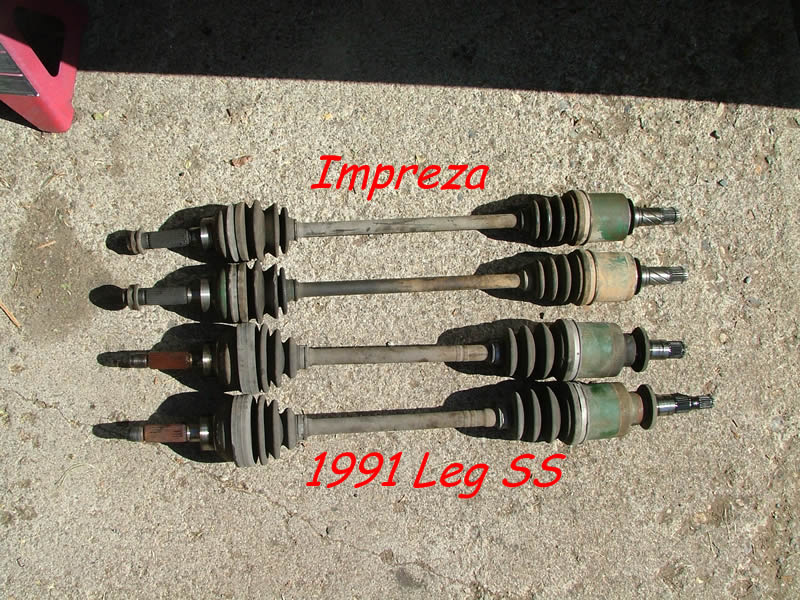

Hey all,
My new '91 SS project is cruising along, and I am at the diff portion.
I am swapping a 4.11 tranny in, and have the matching diff from an Impreza. I've been reading all the stuff on here, and that really helped me get these out with minimal effort, thank you all!
Questions:
1) Confirm I have an LSD in the original case - I thought it would have male stubs!
2) I'm still not exactly sure what to swap and how, as not having the male stubs is confusing me.
I just want to make sure what is going on before I tear into it.
Thanks!
Scotty

You pulled the male stubs out with the cv axles. Find the roll pin remove it, and you should be able to get the stubs out.
Your 91 is a VLSD. As to the details of swapping it over.....I can't say.

Legacy777 wrote:You pulled the male stubs out with the cv axles. Find the roll pin remove it, and you should be able to get the stubs out.
Heh, that's funny right there. Do I get an award?
I'll go have a look.
Edit: yep, the pins are there, covered in grease/dirt. Hopefully that method did not compromise anything.
