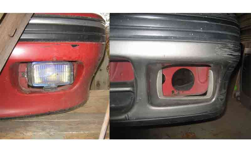

The shape of the fogs section on the jdm and usdm are very different. Jdm is more boxy while usdm is more rounded. I think you still can put jdm fogs on usdm bumper, just might not look to good.
P.S
The fog light on the red usdm bumper is a autozone cheapo and not oem .

Is that a JDM pre-face turbo bumper on the right?

yes

The pre facelift JDM cars had the turn signals in the corner lights, not under the bumper like the USDM cars. That is why there is a difference. One is setup for a turn signal, while the other is setup for a fog light.
