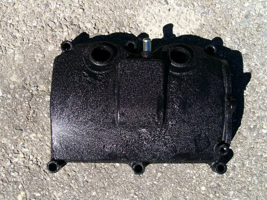

Can you get pictures with a better camera? No offense (and I'm sure it's because of the camera and lighting), but those look craptastic. Hahaha.
That said, I can imagine what they look like in person and I'm sure it's beautiful I seriously love everything you're doing to this car. Like, everything you've done is EXACTLY what I would have done to it as well. I commend your great taste in auto styling. Lol.
it's because I've been getting accustomed to using my phone. the time/effort to post a pic with it is far less. lazy, I know. i'll see what I can do about taking the extra two minutes from now on.

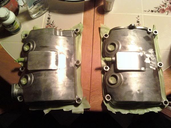

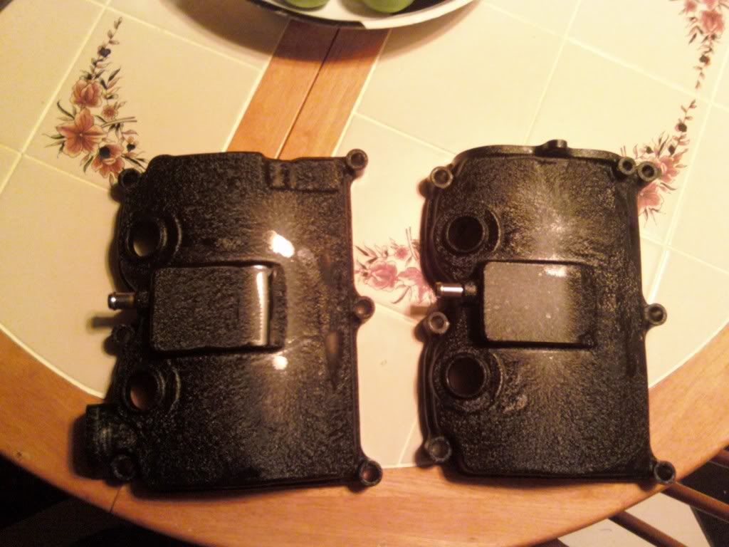

the only prep was to clean with brake clean to get some oil left behind off of the outside, taped off what I didn't want to get painted, wiped with some wax/grease remover prior to paint, then sprayed away. 24 hours later good to go. 48 hours later, ready to install. want pics?

I'd like to see a picture with better lighting. It's hard to tell what they actually look like now in that picture.
I love wrinkle finish, but in dirty locations like an engine bay, I worry that the texture will be difficult to clean.
I might tend to go more towards the hammertone finish, if not just smooth paint.

Haha oooooooooooook now I can see it. Looks good! I think it'll be another nice little mod to throw on the car. I love the little things like that, where you can't really tell EXACTLY what was done, but the car just looks super sexy i.e. this or the blacked out trunk garnish.
And yes, I noted how clean the inside was hahaha.

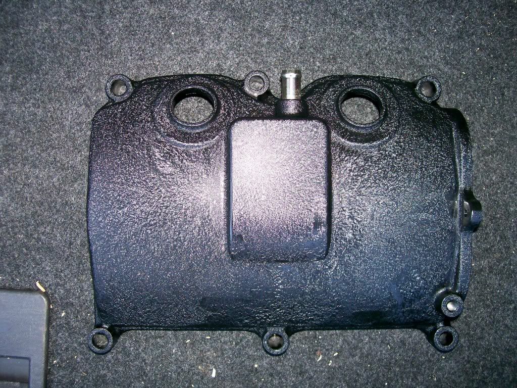

Looks good but looks like it might be a bitch to notice oil leaking on that cover. I guess you might see it on the heads though.
Oil's easy to spot on the crackle finish—it's shiny and, well, oily looking even before it attracts filth. You can see this at classic sports car shows where the cars aren't all trailer queens.
Did you try taking it with the flash off? Almost looks like there's too much flash. Or maybe from an angle would be better. Those pictures look a lot better than the first one though.
get us some installed photo's when you can dude. looks great
