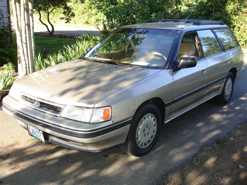

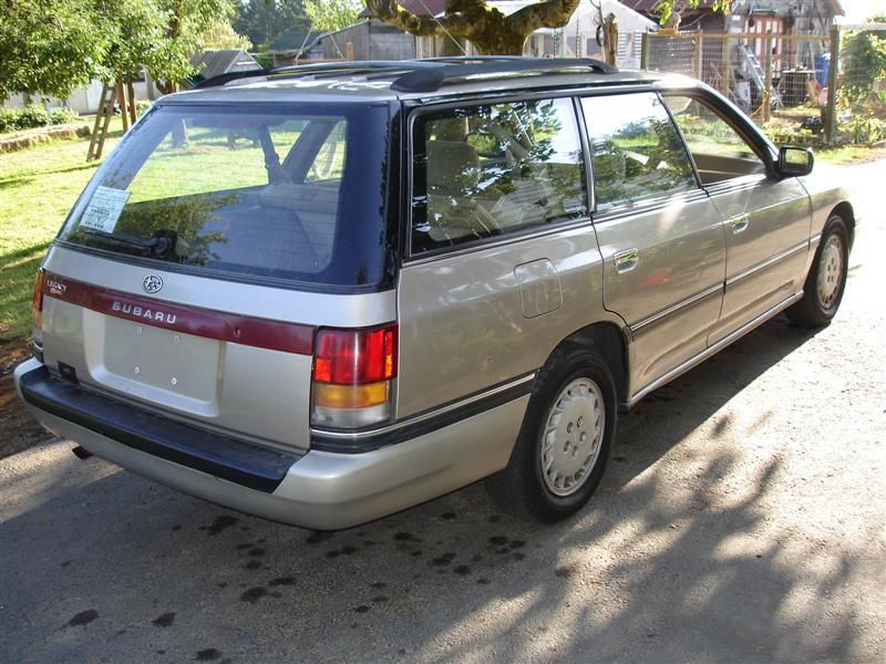

Here's some pictures of it when I bought it for rougly $1,000 after tax and license with a bad throw-out bearing and failing fuel pump.
Lost over $600 on that deal. Never again.
May be a little dirtier on the outside then it was in these pictures but a wash would fix it right up. It's in decent shape. I just wish it didn't have the electrical problems. Mechanical is easy, electrical sucks.

Wow, Kimo, that wagon looks clean! It'd be a shame to part it out. But by the pics, I'm sure you could get more than $500 parting it out.
That being said, if you decide to part it out, I'm interested in the rubber guard/step on the rear bumper.
'94 TW
Unfortunately that's paint, not a rubber step. Some previous owner decided to mask that off and paint it. And they also thought it looked good with a chrome V8 badge on the rear hatch which i promptly removed upon purchasing it. And for some odd reason they painted a black rectangle on the hatch where the V8 badge was located...
It was very clean when I got it because it was from a used car dealer. I'm sure with a quick vacuum and wash of the outside it would still be pretty clean.
