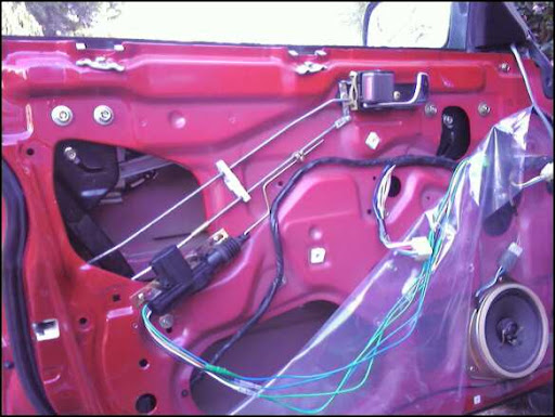

It clears the door panel in the location in the picture. It is kind of difficult to figure out where it will clear, but right there it does!
The one pictured is a '93. I have also done a '90 in case anyone was wondering about pre vs post facelift differences. :wink:

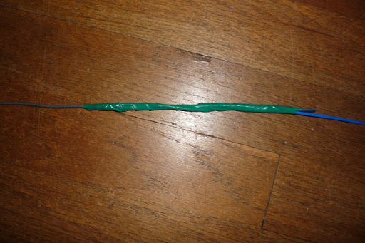

4) I sacrificed an old wire hanger to aid in threading the wiring through the rubber hose between the car body and the door (is there a technical name for this?). One at a time, I taped about 6" of each wire to one end of the hanger, then threaded the open end of the hanger through the rubber tube. A little lubricant made for less work. The picture below is of the wire hanger + actuator wiring.

7) After that was done, I mounted the actuator just like in Binford's picture in my first post. It fits right behind the arm rest of the door panel. I put the door panel back on to ensure that it fit correctly with the actuator installed. Also, the wiring in the kit was a little short, so I used the extra wiring from step 5 to do some splicing and complete the connections. I waited to secure the actuator rod to the locking rod until the actuator was working via remote. The picture below was taken with my camera phone (before taping the wiring together and routing it alongside the other door wiring).
