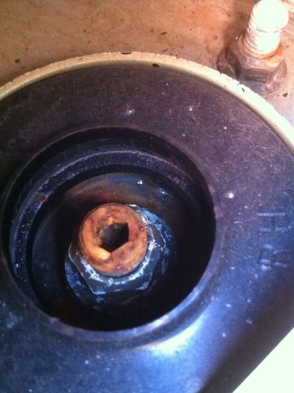

Well I think i found the answer to my clunking problem. Lets take a look
Passenger top hat (good)
Driver rear top hat (not so good)

Yeah that top mount doesn't look so good.

Thanks for the info about the binding. I was thinking that it was maybe caused by low differential fluid. Both the power steering fluid and front differential fluid are low. But then again both front cv axle boots are ripped wide open, so I am sure that is not helping. This thing needs more love than I thought. I ordered a new top hat from subarugenuineparts.com today, hopefully that will come in soon. Next I am going to see what I can do about the exhaust cause it just sounds horrible.

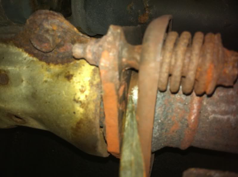

Well I found my exhaust leak, turns out its not as bad as I thought. As you can see in the pic below the gasket is missing between the two pipes and the bolts are too rusted to make any sort of adjustment. I could easily pry them apart with my screwdriver. Some small metallic dropplings also fell out. This is the only place where i could feel and visibly see exhaust gasses leaking when I was under the car. The rest of it looks pretty solid except for the heat shield. Guess I will be visiting the muffler shop this week.
screwdriver inserted and prying
exhaust poop

Yeah, that center gasket is a doughnut gasket that allows for some movement with the spring bolts. it's gone....
