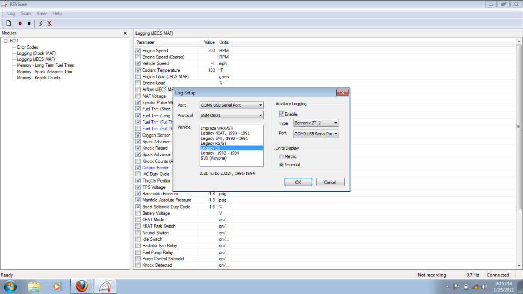

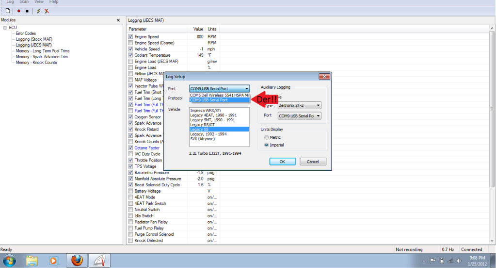

Figured out why I couldn't connect!
Now here's what my setting are at.
Here's a code I got while in bumper to bumper traffic this morning.

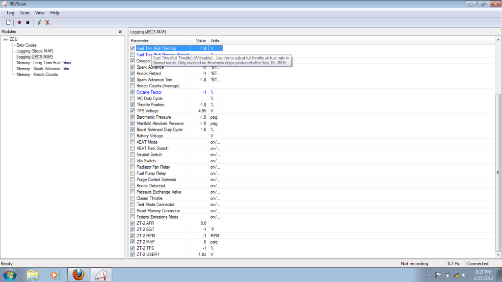

Now here's where I'm at with the Revscan software. Some of the values obviously are not a value and just... something. So I want to know what to do about those and how I am able to play with the fuel trim, help?

Re: Revscan issues!!
Try disabling the wideband support. Last I recall it wasn't finalized and may be causing the data acquisition problems. After restarting RevScan, if you only enable one or two of those problem parameters, it still have problems displaying? Are you using a USB to COM converter per chance? It could also be a source of the data errors. I used one from KeySpan (before purchased by Tripplite) with no problems.
Fuel Trim Full Throttle - Since you're getting invalid data for this one, I'd assume your Revtronix chip was produced before sept 2009. I know this worked with mine and it was flashed after sept 2009. There is no way to tell what revision you have either -- up to the seller to keep the documentation sent from Revtronix/Mike.
Octane Factor - did you just reset the ECU? a value of -1 doesn't look good, as a fully learned ECU should be at 100%. Odd though, because an ECU reset typically would put this value at 25% IIRC. Can you force it to 50%? click in that field and type a number.
'11 WRX Limited

I'm using the cable that Revtronix sold me, and I threw away my receipts and papers from Mike last year thinking I didn't need it anymore but dates would be nice.
I reset the ECU a few months ago, the car's my daily driver right now and I go roughly 45 miles a day. Today I was messing around in it during lunch and saw the throttle % was working but when it goes to zero it goes randomness.
I constantly get that code 45 while driving but this is the best my boost has been in some time. I'm typically going into 20lbs if not higher (the gauge I have in stops at 20) but now it's been limiting it at around 16.

What about all the other suggestions in my first paragraph?
In the rob tune thread, they recently talked about the MAP sensor maxing out around 18 PSI. Sounds like you're possibly maxing it out... although with a TD04 tune, I thought Mike had the chip limited to 17 PSI in power mode... or did you have it changed for your chip?

I tried it without the wideband, and unfortunately still the same randomness. But I did not have any special changes to the chip, just Stage 2 TD04 and 550cc injectors (STi) Here's a another screen shot! My buddy and I started messing around with the pressure switch vacuum lines and got the barometric to change to 1.0 versus the old -1.7 and of course the code 45!!
