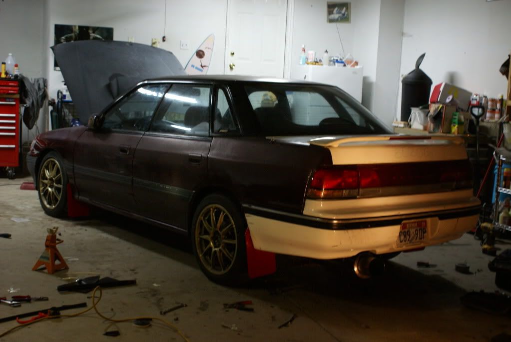

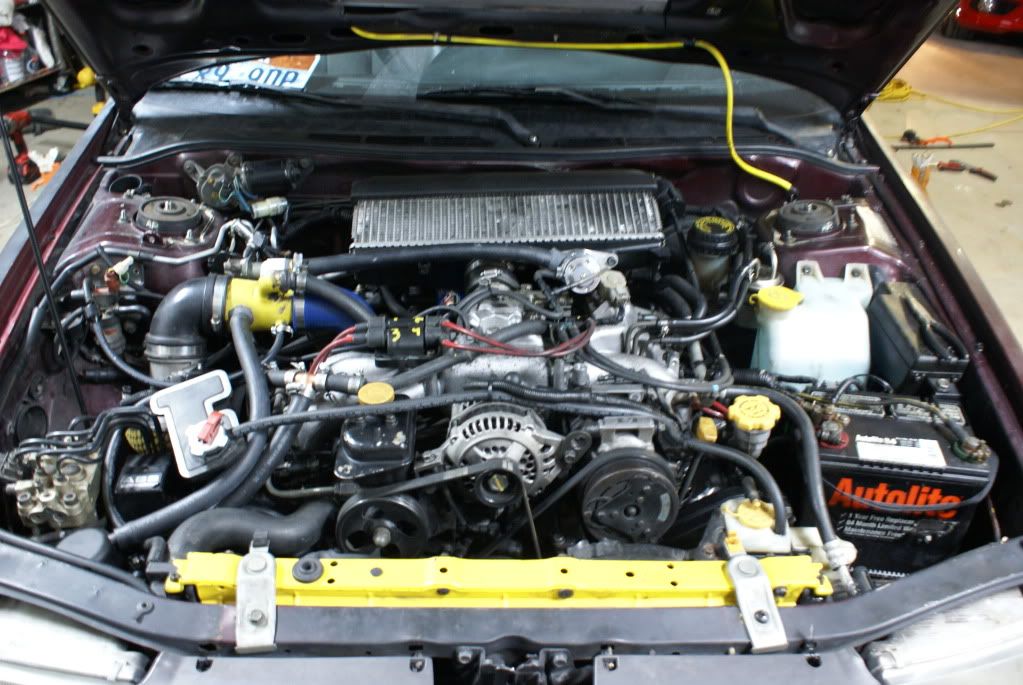

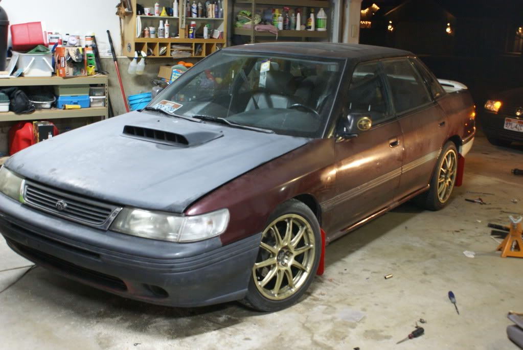

1993 Subaru Turbo Bad Luck Legacy aka STBLL or you can call her Helga.
