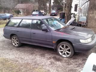

I've been working on my old 94 wagon lately. Mostly to get it ready for the road. I lifted it with the suspension from the 99 forester and replaced the steering rack boots with the ones from the forester.(also did whiteline steering rack bushings) I'm still planning on swapping on the forester lateral links and sway bar mounts as my 94 doesn't have endlink mounts for my whiteline rear bar. I've also got a vlsd rear diff from a 04 forester xt that might get gutted to be added to my 3.9 rear diff.
I just ran into a snag. The ej22 sounds like it has a spun bearing so it looks like it's time for another swap.
This will be my 5th subaru engine swap, but my first obd1 swap.
I have an ej253 from a 99 forester with 54k. The ej253 has 173hp so it should be a nice bump. I figure that this is just telling me the legacy liked all the forester parts I've added to it so far.
