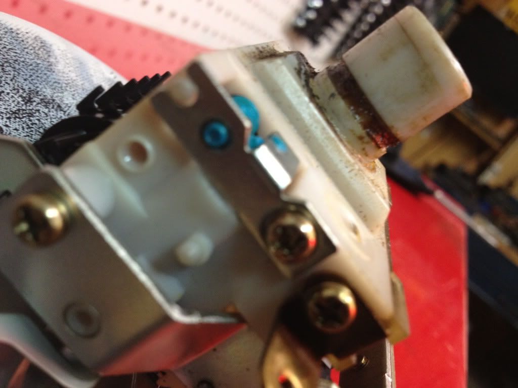

I will also consider trying a 2nd gen electronic speedo and sender wired into the ecu & cluster. I have lots of spare parts to test this with
here is a side pic of the speedo removed from my spare cluster
to add miles to the odometer remove the screw and clip that holds the blue worm gear.
then you can spin the main gear by hand forward only
