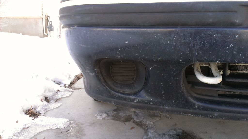

First of is Fog Lights. My front bumper looks to be slightly different than a lot of other Legacys I have seen. However I have seen some with the same or very similar front bumper. It has spots that look like they could fit fog lights and I have seen some people with them and they said they are using JDM Legacy fog lights. Are those JDM Legacy fogs coming off a newer Legacy like late 90's or something because I am not finding any fog lights for legacys from this year/generation. Or does anybody know a fog light that will fit in this space?

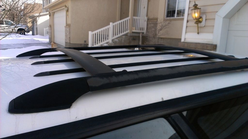

Second would be a roof rack. From my research I"m gathering that Q38 clips and Q towers are what are working for people. Can anyone confirm this? I'm looking for something that will attach to my current rails that are running along the sides of the roof that will allow me to mount some crossbars. The Thule and Yakima fit guides are showing no results for me.

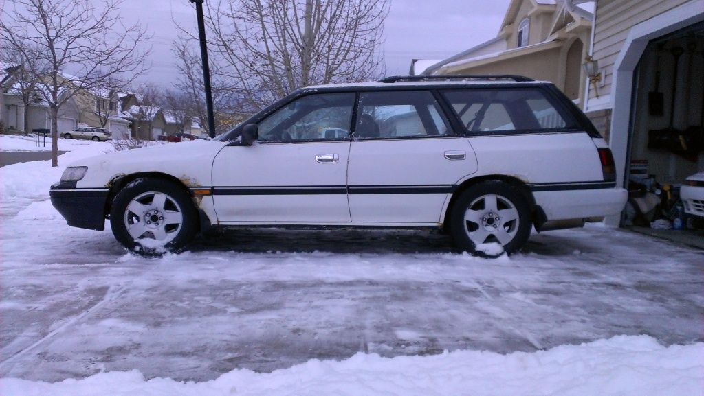

Heres some pics of the new ride. Definitely needs some lovin but that's why I'm here. haha

Regarding the fog lights, most people are using overseas foglights meant for the early Legacies. You have to either find someone selling them or get lucky on ebay. You could probably retrofit a set of aftermarket lights. There were no factory fog lights for the first gen Legacies in north america.

Q38 clips are for the gutters/trim pieces above your window. Not for your OEM Roof Rack.

As far as fogs go, I have heard of people using Integra lights as they fit in there really nicely. I don't have fogs but plan on doing this sometime soon.

Thanks for the replies guys. I actually changed my mind and decided a gutter mount roof rack would work better for me so thanks for confirming they'll work, I'll be picking up a set here pretty soon.
And thanks for the info about the 07 STI v limited lip. That's the one I had heard about but couldn't remember. I'll definitely have to go look at your pics. And my buddy has an Integra so I'll have to see if he has fogs I could test and or buy.
