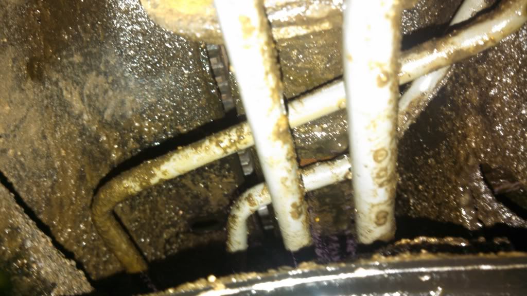

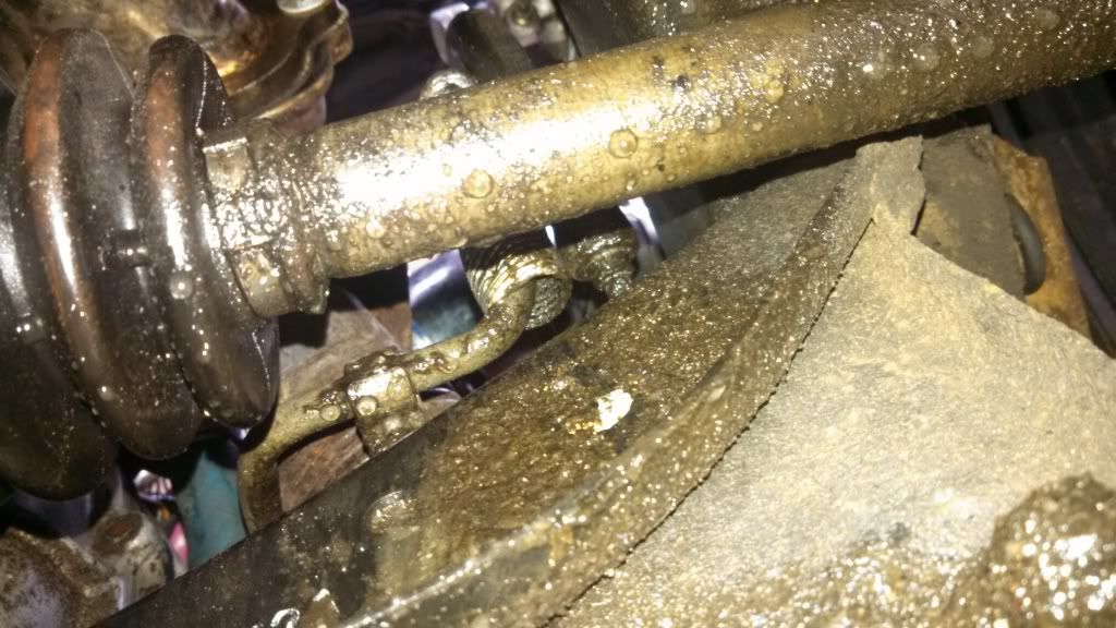

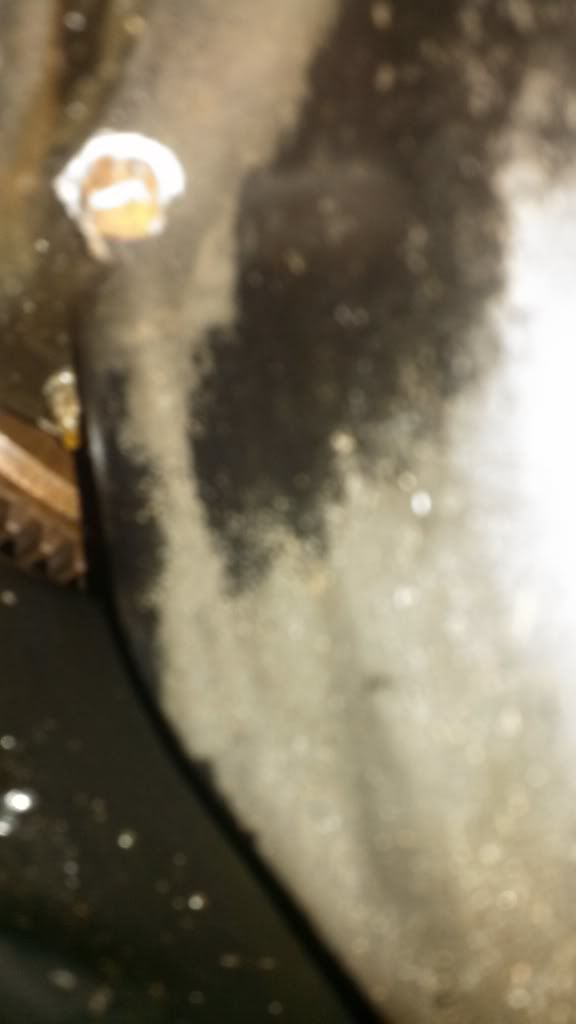

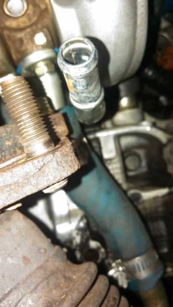

rear main seal was replaced, and i used anarobic sealant around the plate behind the flywheel. Here are some pictures that i took while under the car.
Yes i am running the turbo on oil only currently and no coolant. Just letting the car cool off for a little bit before shutting off. As you can see the underneath of the cross member is disgusting.

Wow that is a lot of oil. It's really tough to say. You sealed the block halves with sealant too? there are also allen bolt plugs under the heads, did you check those? I'm running out of ideas if you just replaced everything. Did you tap the rear main seal in too far or just flush with the crank?

In some of the photos it also looks like there is water down there, do you have a coolant leak as well or did you drive in the rain?
Re: weird oil leak
there were a few water puddles that i had driven through
