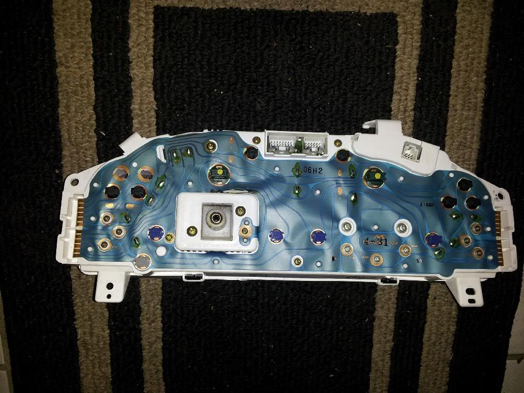

Okay, here's something odd. At some point in the early days of my ej20g swap, I managed to fry one of the traces behind my cluster. It happened after I got the new engine/trans in, but before I touched the wiring at all. Still had the original ecu at the time too. I can't think of any reason it would have happened. Any thoughts? All the bulbs look good though he CEL won't come on now.
Please tell me this isn't indicative of a short somewhere else in the car. No fuses blew. Would a fried cluster prevent the car from starting? I've also gotta find out why my fuel pump mysteriously doesn't prime when I turn my key now also... fun times.
You can see it right above the speedometer.
Re: Burnt my cluster?!
That burnt section appears to be the ground, and is isolated to just the speedo. It should not be causing your problems.
From what you described it sounds like there's something up with your ECU. It may not be getting powered properly which would account for the CEL and fuel pump.
