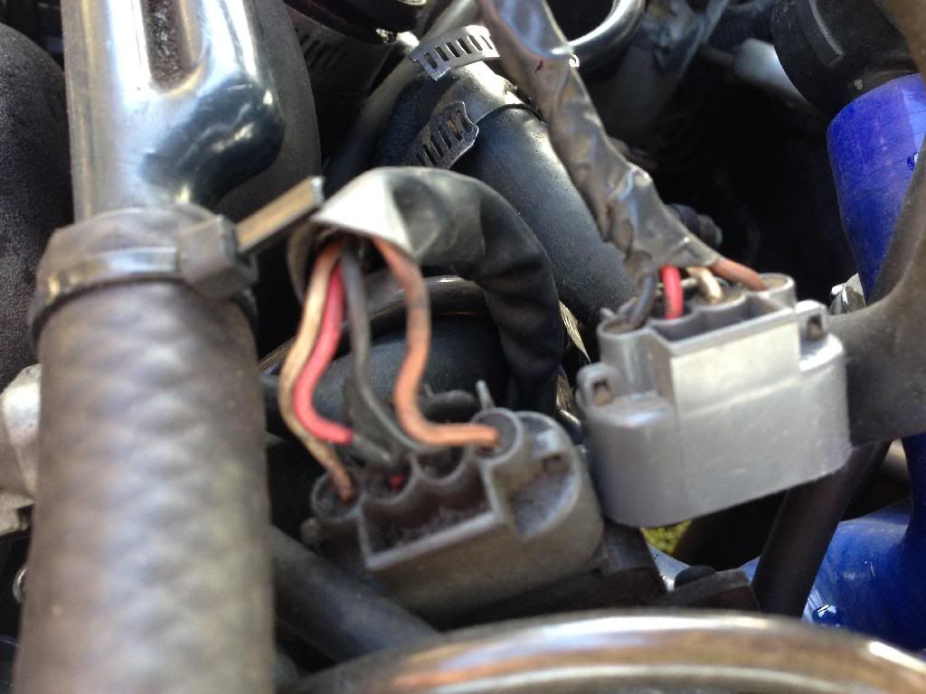

As my previous topic stated i have some idle problems, and have discovered my pigtail leading into the TPS has cut and exposed wires.
I went to the junkyard and cut two pigtails for the TPS off of N/A cars..But the wires on the pigtails i cut are in different positions then the one on the car.
So obviously i would just match the wires position for position, but i can't help but wonder if this will cause problems as maybe different pins have different voltages or something of that nature.
Here is two pictures of the two harnesses i cut next to the factory one on. Notices the colors of the wires in different positions. So all you weird guys that are good with this electrical stuff please chime in if you have some idea what i should do

Hi,
I haven't messed w/my TPS for awhile, but if all 4 wires are the same gauge on each then there's no issue, so as long as you're matching "wires position for position" you're fine.

one was from a 92 and the other one a 94 so post face lift. i guess turbo models were different
1993 legacy ss "Shela"
Posts: 27930
Re: Pigtail problems.... With pictures
The wiring color on your car is correct. I'm not sure why the other connector wire colors are off. If you can de-pin the little pins in the connector so the colors match, that would be good for anyone (including yourself) that has to do testing/troubleshooting in the future.

repinned the connector i got from the junk yard wasnt that hard now i just gotta splice the new one on. Im still curious what the best way to do it is.
Solder or butt splices.

I spliced on the new pigtail fired the car up ran the same just about maybe even a tiny bit lower idle :| that i could not figure out.
Also I noticed that the pig tail i spliced on had different type metal wires. The wire harness on the car had obviously copper wire, the new pig tail all the wires were more silver colored. Will this cause a problem???

I would recommend testing the resistance of the TPS wires from the TPS connector to the ECU. The resistance should be 0 ohms or very close to it. That should tell you whether the wiring and splice is good and going to the correct spots.
