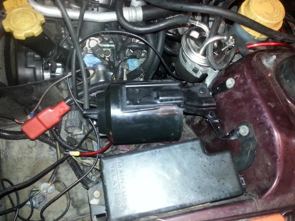

I am installing the charcoal canister on my turbo swap and with the Rob tune ecu the purge control is depinned. I have the turbo canister and the NA canister still. How should I hook up the canister?

what I think I will do is bypass the purge valve and use the vacuum line from the top of the throttle body with the NA canister.

I am having a hard time with posting pictures. A little help?

Then I put the turbo coolant box and my boost control solenoid in that area. this is keeping my engine bay more clean.

I fixed your original picture.
One thing to note about your coolant reservoir location, it really needs to be at the highest spot of the cooling system so air bubbles will go to that and then can escape. Additionally, with it in that location I'm not sure the convective cooling to the turbo will be effective or as effective.
