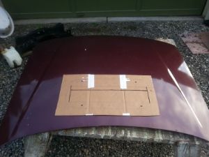

Alright. So I am going to step way out of my comfort zone and attempt an NA hood conversion to a turbo hood. I picked up a 1990 NA hood for $50 at a junkyard. I had previously bought an '03 WRX scoop and splitter that I am hoping to install successfully. Besides for the coffee cup mod, this will be my second attempt at doing something like this. I am excited and nervous because my skills are not really appropriate for this task!
I have read through a lot of the conversion threads for the WRX scoop so I have a pretty good knowledge base. I will be using a dremel with the cutting discs for the top layer cut and then going from there.
If you have advice, post it up. If not, grab some popcorn and watch me screw this up! lol This is a basement project and I have no time limit. Here is where I sit now:

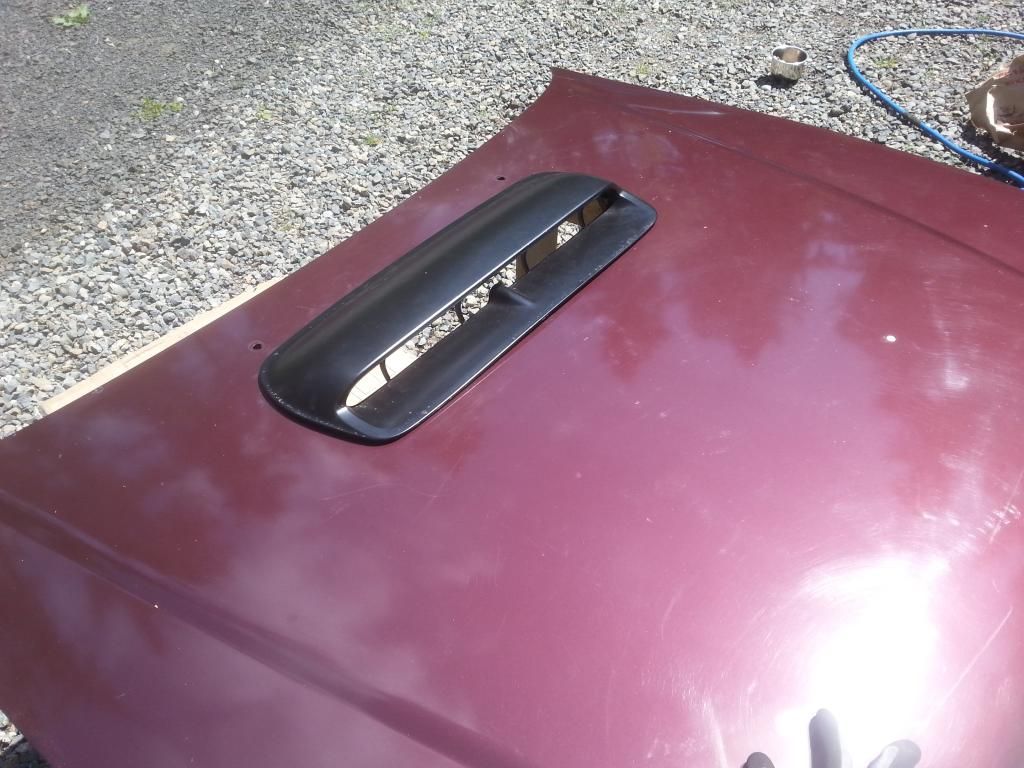

For this project, I should note that I am aiming to satisfy the needs of an 06-07 WRX intercooler with a 2003 WRX scoop. The measurements I need to meet are simple. The back of the scoop is 5/8" in front of the washer fluid sprayers to allow for proper airflow across the entire intercooler face. The intercooler fins are roughly 3" in front of the washer fluid sprayers. The fin area is 4" which brings the grand total space up to 7" where the hole needs to go. This '03 WRX scoop is more than able to handle the needs. Here is a crappy drawing to illustrate what I have outlined:
Next, I decided to just use a center point to launch my placement. I marked the 5/8" in front of the washer sprayers and dropped some masking tape to create my back edge for the scoop. Next, I needed to find the center of the hood and marked this on the tape. I measured between the sprayers to find the half way point.
Next, I found the center of the scoop using the middle clip hole as my reference and marked it. I matched up the two center points (hood and scoop) and measured from the back of the scoop to the edge of the backside of the hood at the sprayers to assure it was equal distance and facing straight.
After I was sure the scoop was centered and straight I traced a line around the scoop. It is important to keep your sharpie angled in to assure you are getting the outline correct. You can see in this picture that I drew at an outward angle creating a bad outline (outside blue line in photo):
I corrected this so that when you are looking down you can see the outer edge of the line peeking out from the scoop edge. Notice how far off the first line is:
Next I measured the clearance needed for the clip housing on the bottom of the scoop on the front/back/sides. The scoop has a thin edge of the hood surface that it will be sitting on. These clip housings on the scoop are not flush with the bottom and therefor sit lower than the hood surface. The back side has about a 1/4" width. The sides and front area have 1/2" width inside of the scoop outline. With these measurements, I measured inside of my outline a 1/2" on the front and sides using a dotted line and 1/4" in from the backside of the scoops outline. This dotted line will be the line that is cut out using a dremel. I also placed a piece of tape across the front line as a sort of cutting guide:
I ended up only using a disc and a half to complete the cut. Once that was done I placed the scoop into the hole to assure proper fitment and to find any areas that needed an extra trim. Everything was good with the measurements I used above!
Once I knew the fit was good I put the scoop back on and marked on the tape at the front of the scoop and the back of the scoop where the clips are. These clips are what will hold the scoop on and eventually we will be drilling holes for these. All we need to do is mark where they are for now. I traced the front of the scoop onto the tape after the clips were marked to verify I hit my lines. Amazingly everything lined up perfectly:
The actual holes for where the stud on the clip will drop down for tightening are 1" away from the edge of the scoop on all six locations (three front and three back). I just measured an inch in from the outer outline of the scoop and placed the dot on the lower supports or second layer of the hood. You can see these on the tape near the back edge of the scoop hole.

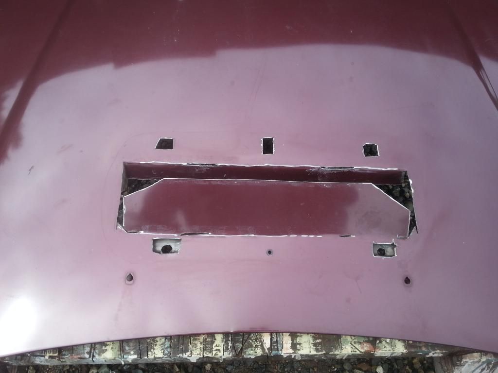

Next I used a wonder bar and popped out the plastic clips holding the dampening material to the top of the hood. All clips are reusable still:
Next it is time to open up the area for the air to flow. I just cut across the straight sections as the measurements were appropriate for opening up this to gain flow across the whole face of the intercooler.

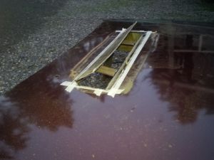

In the picture above you can see that I have also secured the scoop to the hood. I had troubles with getting a hole aligned perfectly with the studs on the scoop clips so on the front side I ended up cutting long, slender, horizontal holes so I would be assured I would get it right. I just used a washer and tightened the nut down and it held perfectly secure.
Next I cut slits in the splitter to align with the scoop. It was a good idea but the studs were not long enough to reach through past the splitters surface. I did notice that there were two holes in the hood that lined up perfectly with two holes at the back of the splitter. The holes on the hood were for the clips that hold the dampening material (pic 2). This centered the splitter properly and gave me extra hold at the back side of the splitter. I ended up using self tapping screws in four spots on the splitter to secure it in place (pic 1).

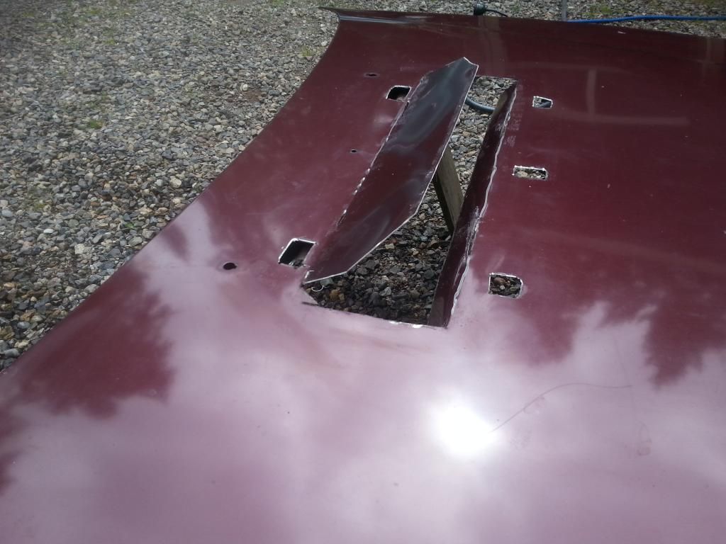

This is how I did it.
I did an H pattern cut in the hood and bent up the back and down the front of the H pattern to keep the air going to the right place with out any extra air damming under the hood.
